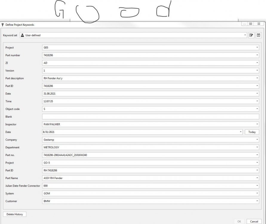

[PA...] Posted September 1, 2021 Share Posted September 1, 2021 Link to comment https://qualityforum.zeiss.com/topic/399-how-do-i-move-or-import-my-header-in-my-define-project-keywords-from-program-tp-program-in-version-2020/ Share on other sites More sharing options...

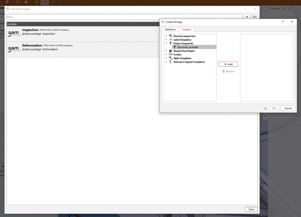

[Da...] Posted September 3, 2021 Share Posted September 3, 2021 Dear Pamela Palmer, this possible via the package manager. There you can choose your user defined project keywords and create an package. This package can then be installed in the 2nd software location. Regards, Daniel Schrein Link to comment https://qualityforum.zeiss.com/topic/399-how-do-i-move-or-import-my-header-in-my-define-project-keywords-from-program-tp-program-in-version-2020/#findComment-1182 Share on other sites More sharing options...
