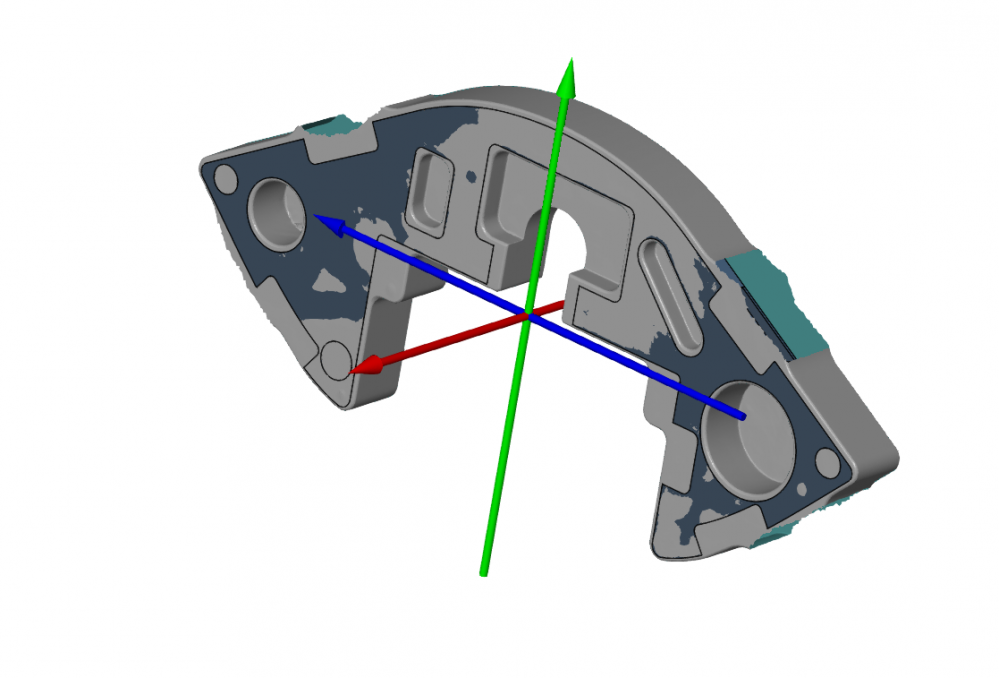

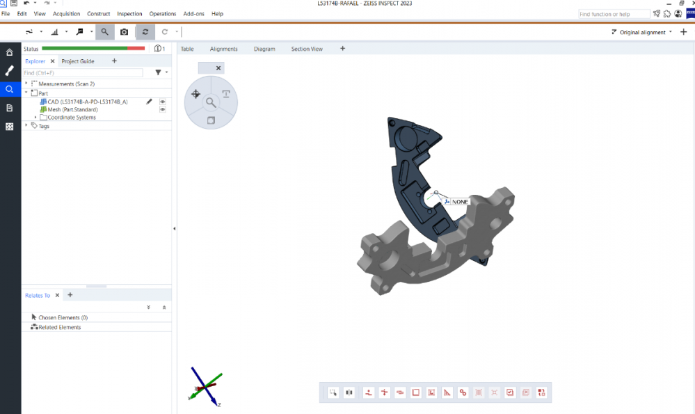

[Ar...] Posted May 26, 2024 Author Share Posted May 26, 2024 The pre alignment doesn't work if i dont cut out some parts of the mesh, and even so, after I cut some parts to match it the front and back planes dont match as they should, meaning idk how to match them so it would be equall on both sides Link to comment https://qualityforum.zeiss.com/topic/3990-aligning-initial-operation-mesh-to-finished-product-model/#findComment-11574 Share on other sites More sharing options...
[Ar...] Posted May 27, 2024 Author Share Posted May 27, 2024 Please sign in to view this quote. I have aligned the mesh and CAD but thickness doesnt match, How can I match both the back and front lanes? Second picture illustrates, the inequality of thickness of one side. Link to comment https://qualityforum.zeiss.com/topic/3990-aligning-initial-operation-mesh-to-finished-product-model/#findComment-11576 Share on other sites More sharing options...

[龙...] Posted May 27, 2024 Share Posted May 27, 2024 Step 1: Pre align Step 2: Establish coordinate systems for two products separately Step 3: Align geometric features Link to comment https://qualityforum.zeiss.com/topic/3990-aligning-initial-operation-mesh-to-finished-product-model/#findComment-11586 Share on other sites More sharing options...

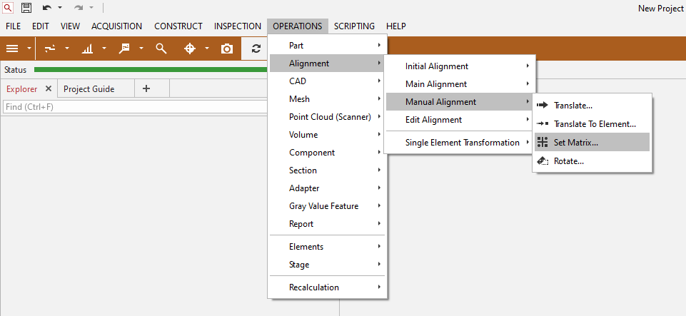

[Ja...] Posted September 16, 2024 Share Posted September 16, 2024 Hi, Sometimes pre-aligning it does not work very well. Select your MESH: Select main alignment - if Main Alignment isn't good still, you may need to manuall align it using X,Y,Z Axes. Really hope this helps Link to comment https://qualityforum.zeiss.com/topic/3990-aligning-initial-operation-mesh-to-finished-product-model/#findComment-12524 Share on other sites More sharing options...
