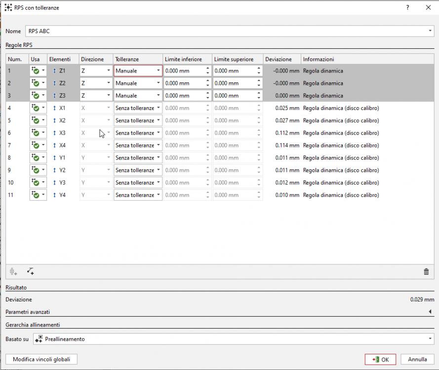

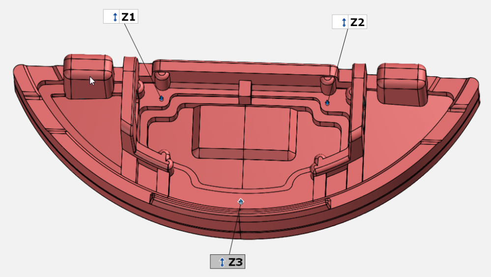

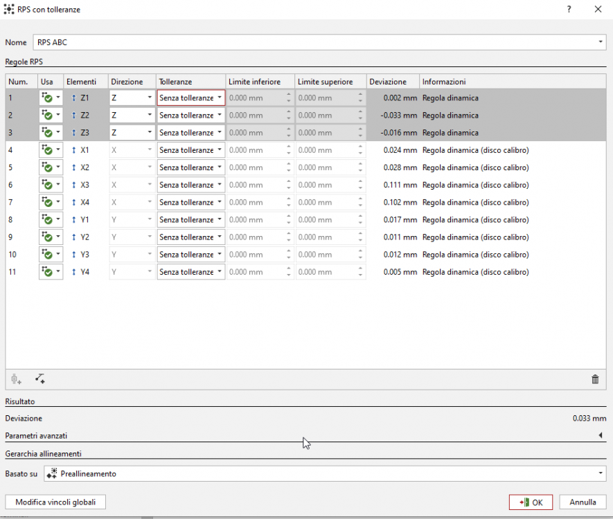

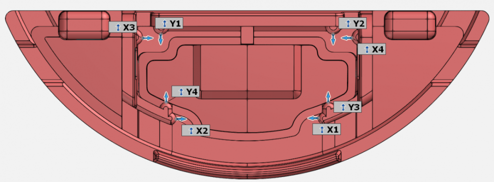

[Ma...] Posted December 29, 2020 Share Posted December 29, 2020 Hello, I have a problem using a RPS With Tollerance Alignment. I use 3 points in Z direction (intersection with mesh), 4 points in X direction (Caliper Disc) and 4 Points in Y directions (Caliper disc). I don't know why Z is not at zero deviation and I must force it by using manual tolerance. What am I doing wrong? Link to comment https://qualityforum.zeiss.com/topic/40-problem-with-rps-alignment/ Share on other sites More sharing options...
[Ma...] Posted December 29, 2020 Author Share Posted December 29, 2020 I found the error. Wrong X taken with caliper. Thank you. Link to comment https://qualityforum.zeiss.com/topic/40-problem-with-rps-alignment/#findComment-100 Share on other sites More sharing options...
