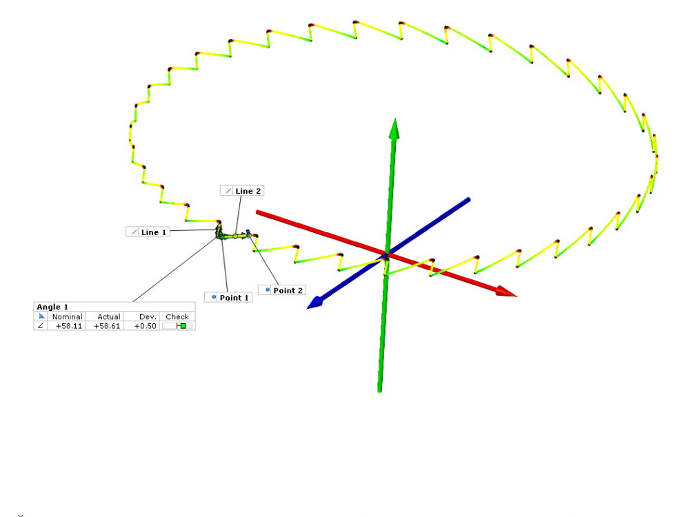

[Jo...] Posted May 29, 2024 Share Posted May 29, 2024 Hi everyone, I want to evaluate this angle on every tooth around 360º. I created 2 points and 1 line, constructed another line with 2 points, and evaluated the angle. My question is: Do I need to create them manually around 360°, one by one? How can I do it automatically? Link to comment https://qualityforum.zeiss.com/topic/4012-how-to-create-patterns/ Share on other sites More sharing options...
[Be...] Posted May 30, 2024 Share Posted May 30, 2024 Hi, I guess you need the 'Cluster' functionality of ZEISS Inspect to "automate" tasks like this (you can find them under Inspection -> Create/Copy Cluster). Regards, Bernd Link to comment https://qualityforum.zeiss.com/topic/4012-how-to-create-patterns/#findComment-11624 Share on other sites More sharing options...
