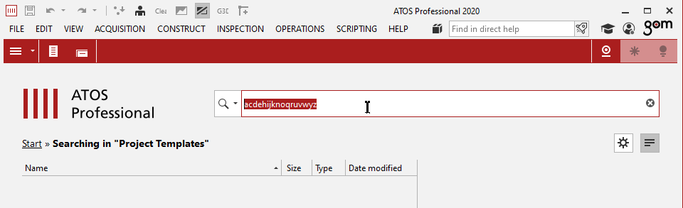

[Ta...] Posted June 3, 2024 Share Posted June 3, 2024 (edited) "Find" in Start->Template. I am unable to type some characters when performing a search (find) in templates. When I type the alphabet, here is all I see: acdehijknoqruvwyz. Anyone else with this problem. Yes, we are still using 2020, for now (June 2024). Thanks! Edited June 3, 2024 Ich war nicht bereits mein Sendung zu Einreichen. Link to comment https://qualityforum.zeiss.com/topic/4019-2020-atos-pro-template-search-typing-not-possible/ Share on other sites More sharing options...
[Na...] Posted June 4, 2024 Share Posted June 4, 2024 Hi Tad, if I remember correct, the omitted letters are defined as shortcuts in the software. Maybe not defining them as shortcuts works as a workaround. The bug was fixed at some point in a newer version (tested it in 2023). Nanno Link to comment https://qualityforum.zeiss.com/topic/4019-2020-atos-pro-template-search-typing-not-possible/#findComment-11641 Share on other sites More sharing options...
