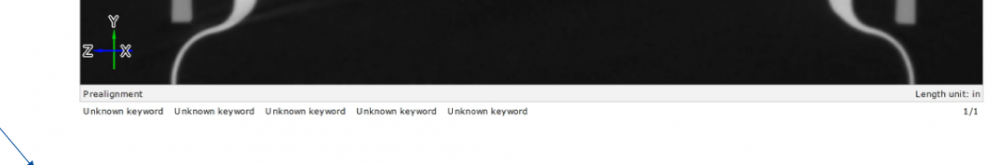

[Br...] Posted June 5, 2024 Share Posted June 5, 2024 Can anyone tell me why this shows up on report pages? Link to comment https://qualityforum.zeiss.com/topic/4027-unknown-keyword/ Share on other sites More sharing options...
[Na...] Posted June 10, 2024 Share Posted June 10, 2024 Hi Brian, there are probably keywords on the report, which are not existing in the current keyword set. Nanno Link to comment https://qualityforum.zeiss.com/topic/4027-unknown-keyword/#findComment-11677 Share on other sites More sharing options...
[Du...] Posted June 11, 2024 Share Posted June 11, 2024 Go to the reports tab, Click on the icon that resembles a KEY (Define Keywords), select the "Keyword Set language" or default. That should correct the "Unknown Keyword" Issue. Link to comment https://qualityforum.zeiss.com/topic/4027-unknown-keyword/#findComment-11695 Share on other sites More sharing options...
[Br...] Posted June 14, 2024 Author Share Posted June 14, 2024 Please sign in to view this quote. This took care of it! Thanks guys, appreciate the help! Link to comment https://qualityforum.zeiss.com/topic/4027-unknown-keyword/#findComment-11759 Share on other sites More sharing options...
