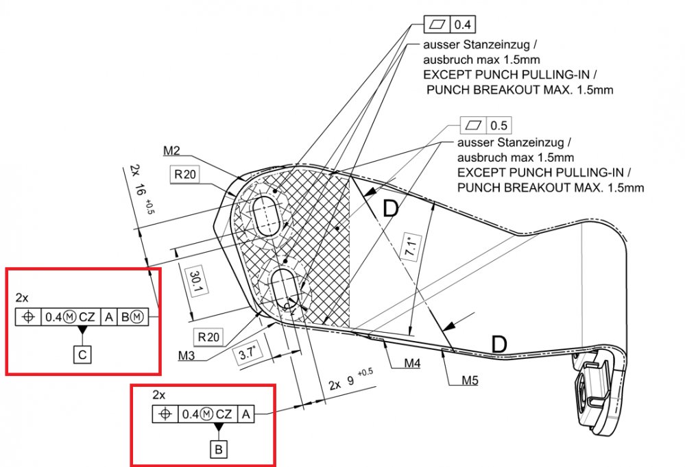

[Ra...] Posted June 6, 2024 Share Posted June 6, 2024 Dear Gom Team, I am facing an issue with checking the GD%T in Gom 2022. I would like to know how to apply MMR on a slot and how to check it with CZ. I kindly request your guidance on this matter. Your assistance would be greatly appreciated. Thank you. Link to comment Share on other sites More sharing options...
[Ch...] Posted June 7, 2024 Share Posted June 7, 2024 Should work out of the box if you combine the two tolerance indication into one. Unfortunetely I can not test it, due lack of a proper project, but the general idea should be 1) Create you two slotted holes in nominal and actual 2) Put your two slotted hole in a element group 3) Create a width and length check on the element group. 4)Create a position tolerance on the element group, using A as datum and a symmetric tolerance from 0.4. Hope this helps. If you need further assistance and have a valid support contract please be free to contact your local partner to get further support. Best regards Christoph Schult Link to comment Share on other sites More sharing options...
[Ra...] Posted June 11, 2024 Author Share Posted June 11, 2024 Hello Christoph, I appreciate your response. I have already tried the idea you suggested, but unfortunately, it did not solve the issue. If you don't mind, could you please share your email so that I can send you the project file? Link to comment Share on other sites More sharing options...
[Ja...] Posted June 13, 2024 Share Posted June 13, 2024 Please sign in to view this username. am i still right in thinking that maximum material condition is not supported on slotted hole grey value features ? Link to comment Share on other sites More sharing options...
[Ch...] Posted June 20, 2024 Share Posted June 20, 2024 Please sign in to view this username. : Sorry, but this is more a task for my collegues at the support department. Therefore, please contact your local partner to get additional support. Please sign in to view this username. : Correct, Grey value features are not supported for any kind of GD&T calculation. Link to comment Share on other sites More sharing options...
