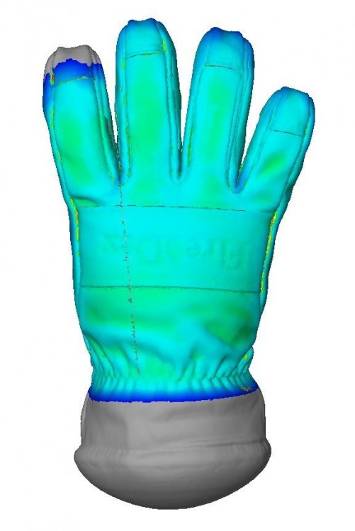

[Ky...] Posted June 24, 2024 Share Posted June 24, 2024 It was the same data, there was no error when I set the Max. Distance to 15MM, but when I suddenly pull it up again and checked, one part was gray and the DEVIATION LABEL was unreadable. Why does this phenomenon occur intermittently? How can I figure out this unreadable part? Link to comment https://qualityforum.zeiss.com/topic/4072-in-surface-comparison-heatmap-colors-are-not-displayed/ Share on other sites More sharing options...
[Je...] Posted June 26, 2024 Share Posted June 26, 2024 Hello Kyurey, please share a screenshot with the surface comparison settings and CAD file visible. I am pretty sure that is related to different normal directions of actual and nominal data. Best regards, Jens Link to comment https://qualityforum.zeiss.com/topic/4072-in-surface-comparison-heatmap-colors-are-not-displayed/#findComment-11868 Share on other sites More sharing options...
