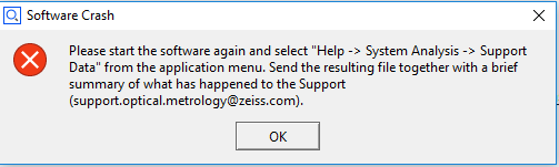

[Ja...] Posted June 25, 2024 Share Posted June 25, 2024 Hello, when I try to use the tool "Arrange elements left to the element" the software crashes, no matte the hotfix since the 2022 version. Do you know how to avoid this? Regards Link to comment Share on other sites More sharing options...

[re...] Posted June 26, 2024 Share Posted June 26, 2024 I do also have the same problem, in my case this is what happens: create a new report page, select several labels, apply the tool that Javier mention and try to move the labels at the same time. By doing this the software crashes 90% of the times I'd really appreciate some feedback to avoid this, Thanks Link to comment Share on other sites More sharing options...

[A...] Posted July 8, 2024 Share Posted July 8, 2024 Hello, I am having the same problem and I tried contacting support but they didn't get back to me. The software crashes most of the time and the "support file" generated from the help button is 58 Gbs so I am not sure what to do. Link to comment Share on other sites More sharing options...
[Na...] Posted July 10, 2024 Share Posted July 10, 2024 Hello, could you please contact us via support.optical.metrology@zeiss.com with your license information (Help -> system -> analysis -> license information. I was not able to recreate a crash with 2022 SP7 nor 2023 SP2. Thanks, Nanno Link to comment Share on other sites More sharing options...

[an...] Posted July 25, 2024 Share Posted July 25, 2024 (edited) Hello, I've had the same problem on two machines, but it occurred only on one single user. I've tried to uninstall all gom / Zeiss Software, deleting registry and \appdata\local\gom / Zeiss and \appdata\roaming\gom / Zeiss as well, nothing worked. Try the following before following the next step: Create a new user, log in and try the same. If moving labels works just fine, then the following step might work for you: In my case the problem was finally solved by logging in with administrative rights, going to system properties, Advanced, User Profiles, Settings and deleting the account data (not the account itself, it's only the data stored at c:\users\%username% which will be discarded). edit: be sure not to delete the directory by shell or explorer, or you won't be able to log on until you remove the account data via system properties then log in with that user again. It's a bit annoying because you have to backup all your data, but for my concerns it fixed it. Andreas Edited July 25, 2024 Link to comment Share on other sites More sharing options...
[re...] Posted July 30, 2024 Share Posted July 30, 2024 Hello Andreas, It's good to hear that you found a way to solve the problem, unfortunately I have no admin rights to follow the instructions The way that I'm working with the tool and avoiding the crash part is: Select the labels that are needed to move Use the tool to arrange the labels evenly Do a click to deselect the labels Select the labels manually again (the same from Step 1) Move all the labels at the same time All of these steps while editing the report page. It takes more time but it is what it is now I guess, I miss gom I appreciate the help! Thanks Link to comment Share on other sites More sharing options...
