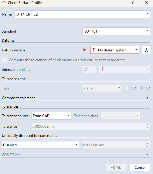

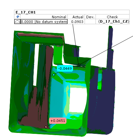

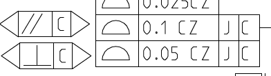

[Ma...] Posted July 17, 2024 Share Posted July 17, 2024 i have a surfaceprofile with indicators . How can i activate the intersection plane? ( // or Perpendicular to C) Regards Mark C. Link to comment https://qualityforum.zeiss.com/topic/4121-check-surface-profile-how-to-work-with-intersection-plane-perpend/ Share on other sites More sharing options...
[Na...] Posted July 23, 2024 Share Posted July 23, 2024 Hello, the intersection plane in the dialog is referring to the filtering method on the bottom. It is not available for surface profiles: https://techguide.zeiss.com/en/zeiss-inspect-2023/article/cmd_inspection_check_gdat_surface_profile.html#mark-3 Please sign in to view this quote. The indicator's intention might be the direction, in which the surface profile is measured (e.g. like scanning with a tactile cmm). In this case you could check the surface for line profile. Nanno Link to comment https://qualityforum.zeiss.com/topic/4121-check-surface-profile-how-to-work-with-intersection-plane-perpend/#findComment-12081 Share on other sites More sharing options...
