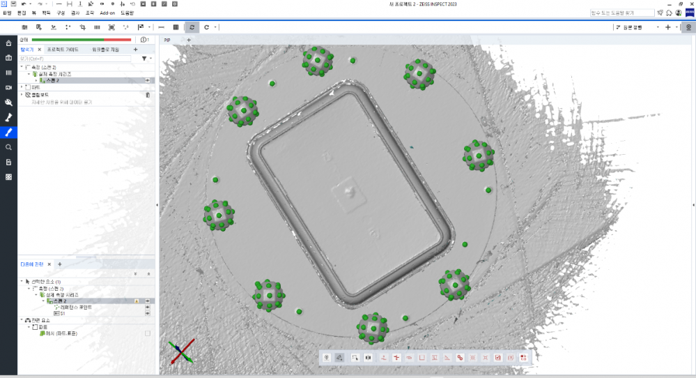

[JU...] Posted August 5, 2024 Share Posted August 5, 2024 Hello, I have an inquiry regarding the conversion to mesh. First, we scanned the product in 3D with T-Scan Hawk2 from various perspectives. However, when the 3D scan is completed and polygon model, the scanned part is deleted as shown in the picture above. Is there a solution? Link to comment https://qualityforum.zeiss.com/topic/4172-i-have-an-inquiry-regarding-the-conversion-to-mesh/ Share on other sites More sharing options...
[Je...] Posted August 15, 2024 Share Posted August 15, 2024 Good morning, the deleted areas seem to be full of noise. Is this a reflective part? Please try to measure those areas from different angles to get better results, otherwise those area might get filtered out during polygonization process. Best regards, Jens Braun Link to comment https://qualityforum.zeiss.com/topic/4172-i-have-an-inquiry-regarding-the-conversion-to-mesh/#findComment-12221 Share on other sites More sharing options...
[Th...] Posted August 19, 2024 Share Posted August 19, 2024 What is the material and color of the part? Using a little bit of scanning spray, or developer spray should alleviate that. Dark and shiny parts are your enemy. Link to comment https://qualityforum.zeiss.com/topic/4172-i-have-an-inquiry-regarding-the-conversion-to-mesh/#findComment-12255 Share on other sites More sharing options...
[Aa...] Posted August 21, 2024 Share Posted August 21, 2024 Titanium dioxide in alcohol spray works the best in my opinion. The mixture needs ultrasonic agitation to work properly though. Link to comment https://qualityforum.zeiss.com/topic/4172-i-have-an-inquiry-regarding-the-conversion-to-mesh/#findComment-12273 Share on other sites More sharing options...
