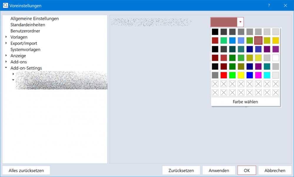

[An...] Posted August 15, 2024 Author Share Posted August 15, 2024 Hello Mr. Prinke, Thank you for your reply and for pointing out that the “file” type is currently the only “exotic” type that can be used here. What I actually need is shown in the attached photomontage... Link to comment Share on other sites More sharing options...
[Ma...] Posted August 16, 2024 Share Posted August 16, 2024 Hello Mr. Gallasch, I already assumed that you had this in mind. A color selection widget is currently not implemented in the Add-on Settings. Please feel free to file a request via Software Support. Best regards, Matthias Prinke Link to comment Share on other sites More sharing options...
