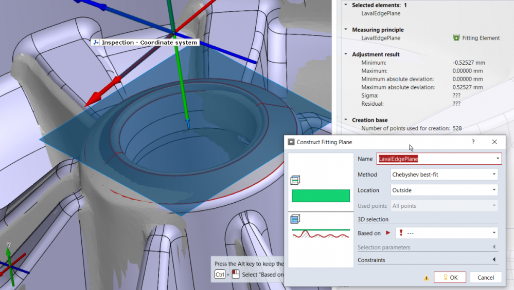

[Fe...] Posted August 21, 2024 Share Posted August 21, 2024 Hi, I have a question to experts to make to following: I have a injection molded valve seat with cyllindrical surface. I need to know the surface normal of the fitting plane. ( ...evaluate the direction of warpage ) What I did up to now: - selected the surface from cad patches -created a nominal plane with chebisev/ outer fit. - I have selected the measurement principle as fitting element. My questions are: - Is my method is good to do what I trying to achieve? - How I can get the direction (normal vector) of the measured plane? Thank you in advance. Ferenc Link to comment https://qualityforum.zeiss.com/topic/4205-plane-normal-on-touching-surface/ Share on other sites More sharing options...
[Ch...] Posted August 22, 2024 Share Posted August 22, 2024 I would recommend using Gaussian best-fit (outer), since it is less sensitive on the extend of the actual selection than Chebyshev. The normal of the plane is available in any command that uses a direction by selecting it in the respective widget. For scripting (or user defined checks), the normal can be accessed via gom.app.project.actual_elements['LavalEdgePlane'].normal. Link to comment https://qualityforum.zeiss.com/topic/4205-plane-normal-on-touching-surface/#findComment-12275 Share on other sites More sharing options...
