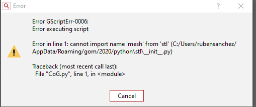

[Ru...] Posted October 14, 2021 Share Posted October 14, 2021 Please sign in to view this quote. When I try this option I'm getting this message "cannot import name 'mesh' from 'stl'. Any suggestion? Link to comment https://qualityforum.zeiss.com/topic/421-schwerpunkt-eines-meshs-ausgeben/#findComment-1432 Share on other sites More sharing options...

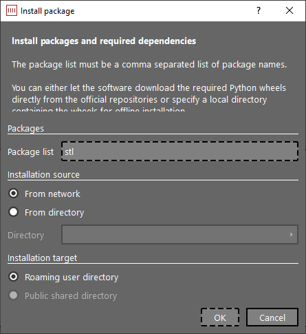

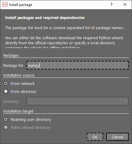

[Je...] Posted October 15, 2021 Share Posted October 15, 2021 (edited) Hey Ruben, This Error is caused by some missing libraries. In your case the Python is not able to make use of line 1 of the code. So the library stl (which includes the sub-functionality mesh) is missing. The same could be the case with numpy. To solve this issue, please make use of the system script 'Install Python Package' which can be found through: --> Scripting >>> Script Choice >>> Tools >>> Install Python Package. In here you type in the missing Python library and the GOM Inspect will install the add-on automatically. stl --> numpy --> Hope this helps! Edited October 15, 2021 Link to comment https://qualityforum.zeiss.com/topic/421-schwerpunkt-eines-meshs-ausgeben/#findComment-1446 Share on other sites More sharing options...
