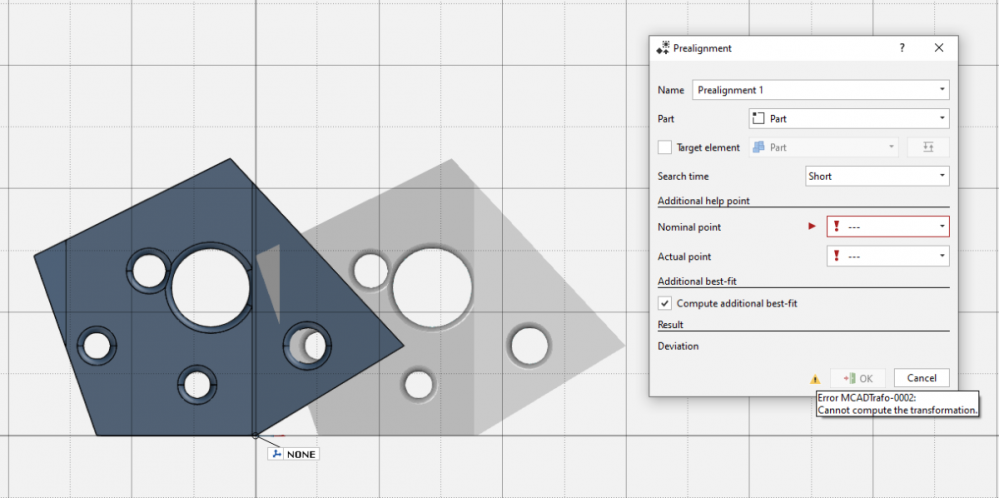

[Kü...] Posted September 4, 2024 Share Posted September 4, 2024 Hi, I can't prealingment my Solidworks step files but there is no problem with Siemens NX step files. How can I fix it? Link to comment https://qualityforum.zeiss.com/topic/4241-prealignment-problem/ Share on other sites More sharing options...
[Be...] Posted September 4, 2024 Share Posted September 4, 2024 Hi, have you already increased the search time? Unfortunately your part is very flat, sometimes it helps to define an additional help point. For a deeper investigation you have to contact your local ZEISS support and you have to supply the concrete datasets. Regards, Bernd Link to comment https://qualityforum.zeiss.com/topic/4241-prealignment-problem/#findComment-12389 Share on other sites More sharing options...
[Kü...] Posted September 4, 2024 Author Share Posted September 4, 2024 (edited) Thank you for your quick response. As you said, the problem was due to the part being flat. Even though I increased the time and added an extra help point, I could not get any results, but when I tried other parts that were not flat on solidwork, I was able to pre-align without any problems. Edited September 4, 2024 Link to comment https://qualityforum.zeiss.com/topic/4241-prealignment-problem/#findComment-12391 Share on other sites More sharing options...

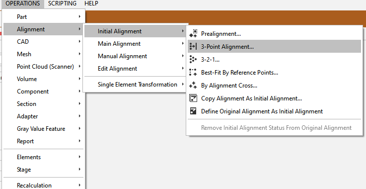

[Be...] Posted September 5, 2024 Share Posted September 5, 2024 If the 'Prealignment' is not working for your part choose a different alignment strategy, e.g. 3-Points followed by a 'Bestfit-Alignment' Regards Link to comment https://qualityforum.zeiss.com/topic/4241-prealignment-problem/#findComment-12411 Share on other sites More sharing options...
[Ja...] Posted September 12, 2024 Share Posted September 12, 2024 Hi, I had a similar issue with flat surfaces - Use: This would help guide the alignment. You could also use the "Actual" and "Nominal" points, try putting the points in the same location as the nominal point you've given it. Really hope this helps Link to comment https://qualityforum.zeiss.com/topic/4241-prealignment-problem/#findComment-12486 Share on other sites More sharing options...
