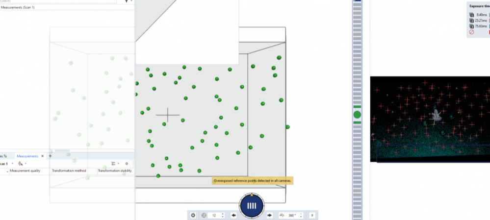

[El...] Posted September 12, 2024 Share Posted September 12, 2024 Hello, What is the cause of the error in the image below? Link to comment https://qualityforum.zeiss.com/topic/4262-overexposed-reference-points-detected-in-all-cameras/ Share on other sites More sharing options...
[Je...] Posted October 10, 2024 Share Posted October 10, 2024 Hello Elif, this means that you need to lower the exposure time for the reference points, Best regards, Jens Braun Link to comment https://qualityforum.zeiss.com/topic/4262-overexposed-reference-points-detected-in-all-cameras/#findComment-12814 Share on other sites More sharing options...
