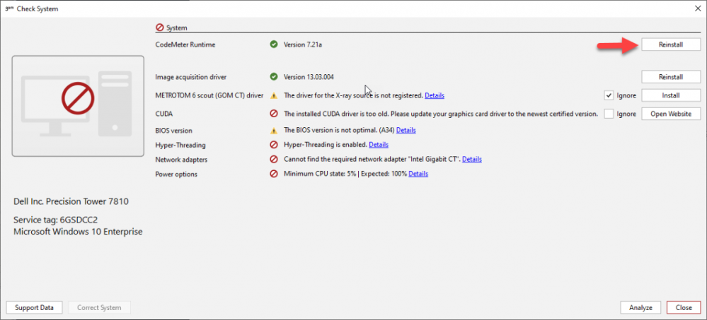

[Ph...] Posted September 14, 2021 Share Posted September 14, 2021 Hello, We've just got used ATOS Scan device with the sofwares ATOS Profesional and Gom Inspect Professional.When we run either sofwtare the launching fails and a error message is displayed on the screen(see file attached).I attached too a Gomsic Report.Yet,the dongle Key is plugged. Is there anybody who can help me? gomsic-report-2021-09-14-10-22-33.tgz Link to comment Share on other sites More sharing options...
[Na...] Posted September 15, 2021 Share Posted September 15, 2021 Hello Philippe, please chose "Check System" and try to (re)install Codemeter. Maybe a manual reinstallation might help too by deinstalling it in windows, then run check system in our software and install it there. Regards, Nanno Link to comment Share on other sites More sharing options...
