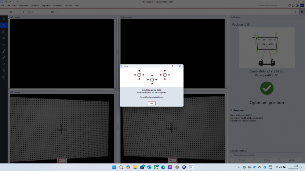

[Va...] Posted September 18, 2024 Share Posted September 18, 2024 (edited) Does somebody can help me with this calibration error please? What can I do? I'm new in this software Edited September 18, 2024 Link to comment https://qualityforum.zeiss.com/topic/4282-gom-scan-1-calibration-error-msensorcal-0205/ Share on other sites More sharing options...

[Ri...] Posted April 14 Share Posted April 14 It doesn't look like the sensor even sees anything. Is everything connected properly? Link to comment https://qualityforum.zeiss.com/topic/4282-gom-scan-1-calibration-error-msensorcal-0205/#findComment-149096 Share on other sites More sharing options...
[Ma...] Posted April 14 Share Posted April 14 Please sign in to view this username. I've never experienced this, but Please sign in to view this username. reminded me, that today i had a situation, where i've turned/moved sensor and it was suddenly darker image and there was no ref. points marked. I had to increase from 17ms to 48ms and still not getting correct image. Then i touched optical cable to ATOS and it was loose. After tightening screw it was back on. Perhaps this can be your problem - since your images shows no crosses ( if they should be there ) Link to comment https://qualityforum.zeiss.com/topic/4282-gom-scan-1-calibration-error-msensorcal-0205/#findComment-149100 Share on other sites More sharing options...
