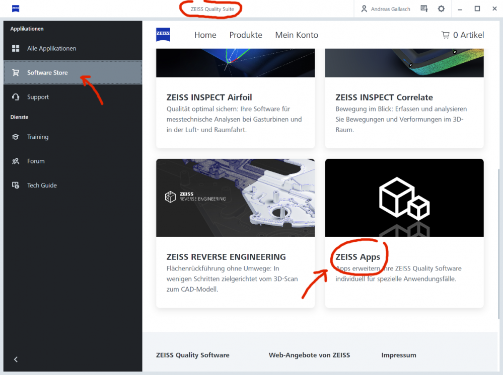

[An...] Posted September 27, 2024 Share Posted September 27, 2024 Hi everyone!! where you can download new add-ons? thank you! Andrea Link to comment https://qualityforum.zeiss.com/topic/4314-add-on-download/ Share on other sites More sharing options...
[An...] Posted September 27, 2024 Share Posted September 27, 2024 Hello Andrea, You can get add-ons for ZEISS Inspect via the ZEISS Quality Suite (ZQS) after you have logged in to the suite. There is a section called ‘Software Store’ and then ‘ZEISS Apps’. Link to comment https://qualityforum.zeiss.com/topic/4314-add-on-download/#findComment-12680 Share on other sites More sharing options...
