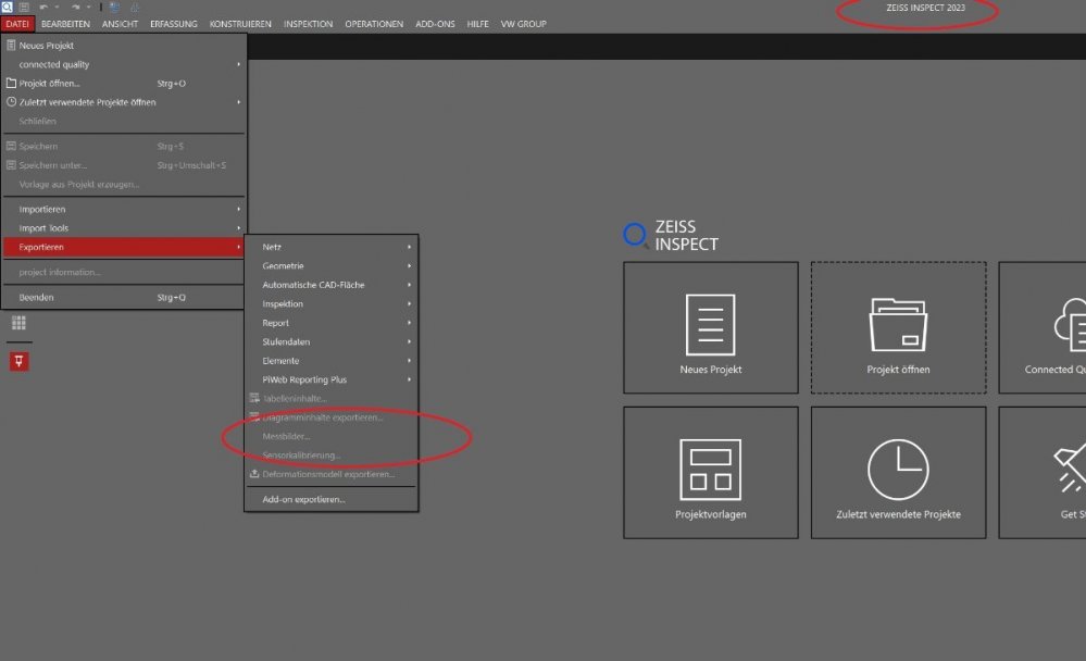

[Ku...] Posted October 1, 2024 Share Posted October 1, 2024 In Inspect 2022 there was the option to Export -> "Measurement Images...." but in Zeiss Inspect Optical 3D the option is no longer there. We are using our ATOS Q to create archival scans of works of art and historical objects so exporting the individual images from the camera gives us additional data to have a fuller document of the object (and this is data we prefer to export to non-proprietary format like .tif, .jpg, .png so it is accessible years from now). Has this moved or has the option been removed from the software? Link to comment https://qualityforum.zeiss.com/topic/4320-export-measurement-images/ Share on other sites More sharing options...
[Je...] Posted October 7, 2024 Share Posted October 7, 2024 Hello Kurt, this feature is still there, see screen. Can you share how it looks at your software? The free version does not support this feature. Best regards, Jens Braun Link to comment https://qualityforum.zeiss.com/topic/4320-export-measurement-images/#findComment-12764 Share on other sites More sharing options...

[Na...] Posted October 23, 2024 Share Posted October 23, 2024 Hello, maybe this function is for you? https://techguide.zeiss.com/en/zeiss-inspect-2023/article/cmd_sys_reduce_project_size.html (with keep image mapping). Storing the images disconnected from the project might come with some other problems I imagine. Nanno Link to comment https://qualityforum.zeiss.com/topic/4320-export-measurement-images/#findComment-12950 Share on other sites More sharing options...
