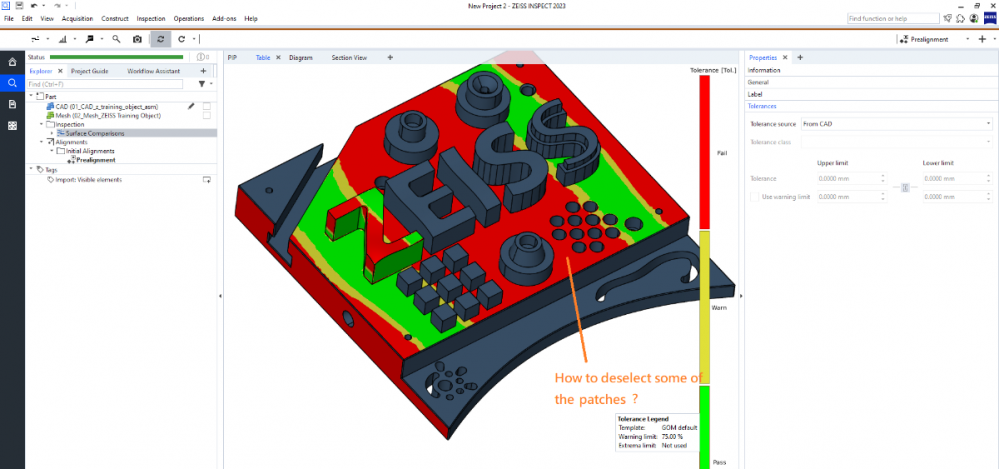

[Wi...] Posted October 18, 2024 Share Posted October 18, 2024 How to deselect the patches which is selected at "Edit Patches" function? How to show all the patches we are selected before? I do surface Comparisons with Tolerance legend (Tolerance source:From CAD) I only can add more patches by "Edit Patches" function , but I don't know how to deselect some of them. Please advice, thank you. Link to comment https://qualityforum.zeiss.com/topic/4362-question-on-deselect-the-patches-which-is-selected-at-edit-patches-function/ Share on other sites More sharing options...
[Je...] Posted October 22, 2024 Share Posted October 22, 2024 Hello William, while using this function patches can be selected with CTRL+LMB and also deselected with CTRL+LMB. I also recommend to switch the patch colour for a better overview which patches have already been edited. Best regards, Jens Link to comment https://qualityforum.zeiss.com/topic/4362-question-on-deselect-the-patches-which-is-selected-at-edit-patches-function/#findComment-12934 Share on other sites More sharing options...
