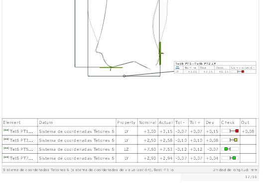

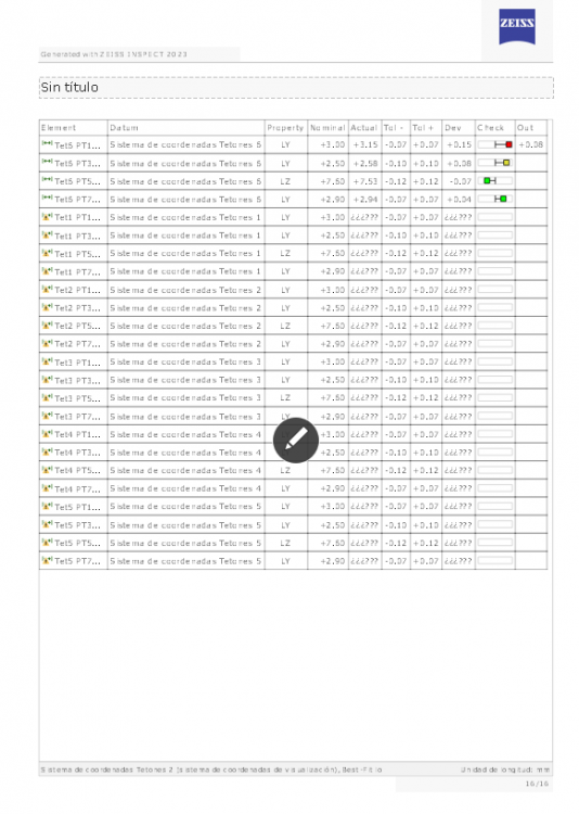

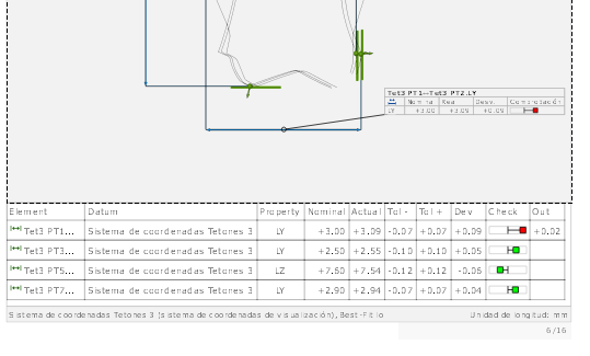

[Er...] Posted October 24, 2024 Share Posted October 24, 2024 Hello, I want to create a table with all the measurements that I have created during the inspection. The measurements are taken with different BestFit, so I can generate individual tables with the measurements of each best fit, but I can't put them all together in one table. How should I do this? Measures with individual BestFit. General table (Only the measures taken with the actual BestFit apears, the measures that I´ve created with another Best Fits don´t apears. Link to comment https://qualityforum.zeiss.com/topic/4376-create-a-table-with-all-the-measures-that-i%C2%B4ve-created/ Share on other sites More sharing options...
[Na...] Posted October 24, 2024 Share Posted October 24, 2024 Hi Erik, we have an FAQ article for this: ZEISS Quality Tech Guide Link to comment https://qualityforum.zeiss.com/topic/4376-create-a-table-with-all-the-measures-that-i%C2%B4ve-created/#findComment-12964 Share on other sites More sharing options...
[Er...] Posted October 24, 2024 Author Share Posted October 24, 2024 Hi Nanno, I have been watching the video. I´ve also tried to reproduce it, and I can do it with Surface Points, but when I try it with Disco Contact Point, it doesn´t work. Do you know if it is possible? Thank you in advance Link to comment https://qualityforum.zeiss.com/topic/4376-create-a-table-with-all-the-measures-that-i%C2%B4ve-created/#findComment-12972 Share on other sites More sharing options...
