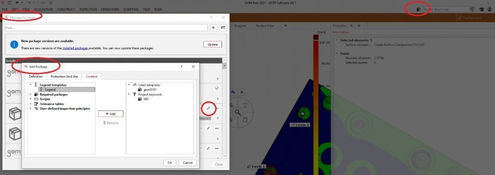

[Fr...] Posted September 21, 2021 Share Posted September 21, 2021 Hi, How do I Import/Export Surface Comparison Legend Template? Current here is only "Gom 3 color" "Gom 8 color" ect, I want export or import my own to the software. Thanks, Link to comment https://qualityforum.zeiss.com/topic/442-importexport-surface-comparison-legend-template/ Share on other sites More sharing options...
[Je...] Posted September 22, 2021 Share Posted September 22, 2021 Hello Frank, after saving your individual template you can add this to a package: Manage Packages - Edit Package - Content - Legend Templates - "Add". This Package can be exported/imported shared to use this template in other projects or on other computers. Best regards, Jens Heidler Link to comment https://qualityforum.zeiss.com/topic/442-importexport-surface-comparison-legend-template/#findComment-1310 Share on other sites More sharing options...
