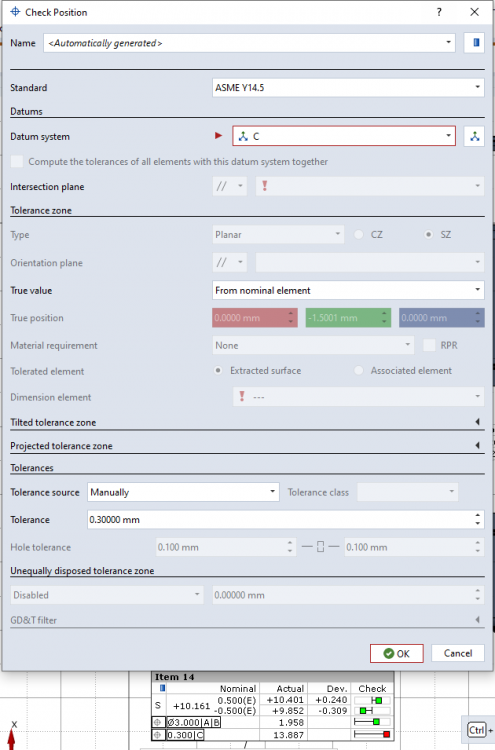

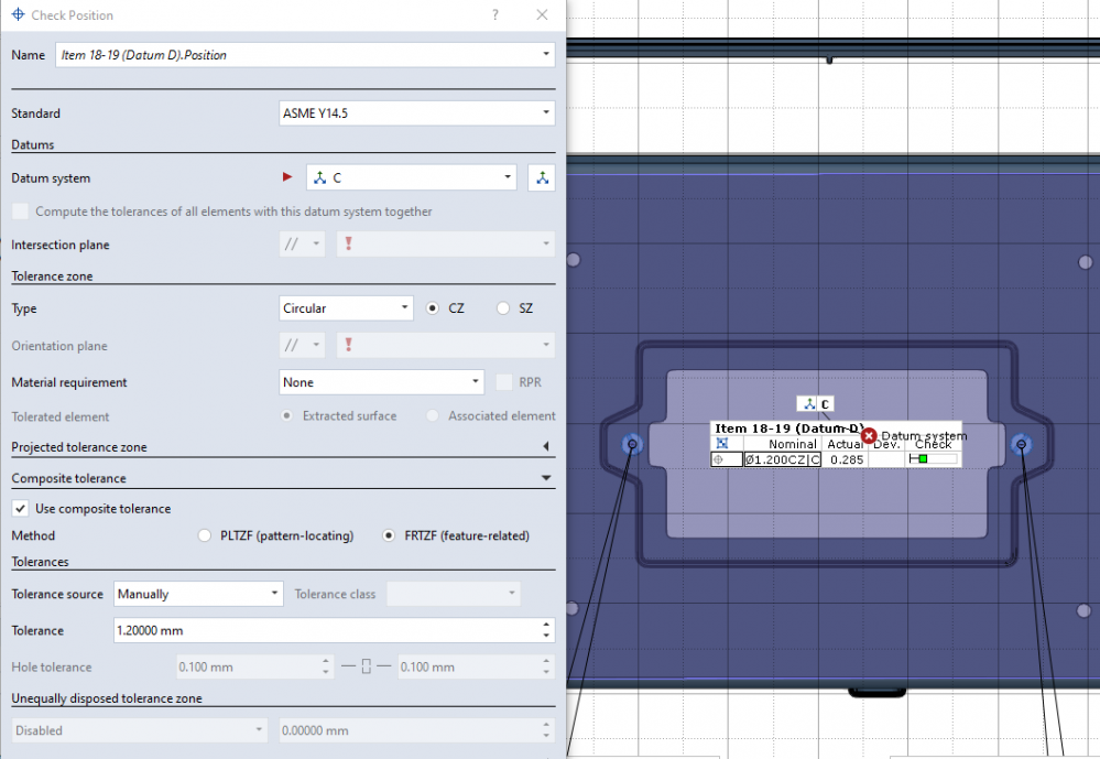

[Ed...] Posted November 6, 2024 Share Posted November 6, 2024 Hello, Is there a way to report the positions of the individual features that make up a feature pattern? I seem to be able to only create a single composite position of the group element, but not for each individual feature which are part of the pattern. (cannot inspecting for individual form) Is the resulting .285" position an average of the 2 features? Multiple single segment does not appear as an option here. I tried adding a second position control on the individual features, but it will only give me a Planar Tolerance zone, whereas I need circular. I know it's a lot, but anything helps. Thank you for your time. Link to comment https://qualityforum.zeiss.com/topic/4420-compositemms-position-tolerance/ Share on other sites More sharing options...
[Mi...] Posted November 7, 2024 Share Posted November 7, 2024 Please sign in to view this quote. It's the maximum deviation of the two features, not the average. The only way to see which deviations occur for each feature individually is to look at the coloured deviation in the 3d view or maybe a deviation label (min./max. picker). Please sign in to view this quote. The position dialog for a single feature offers only a planar tolerance zone because the datum C is presumably a plane here and the distance of the extracted cylinder axis to the datum plane will be checked. When the position tolerance is applied to an element group, the dialog will offer circular tolerance zones as well. Link to comment https://qualityforum.zeiss.com/topic/4420-compositemms-position-tolerance/#findComment-13114 Share on other sites More sharing options...
