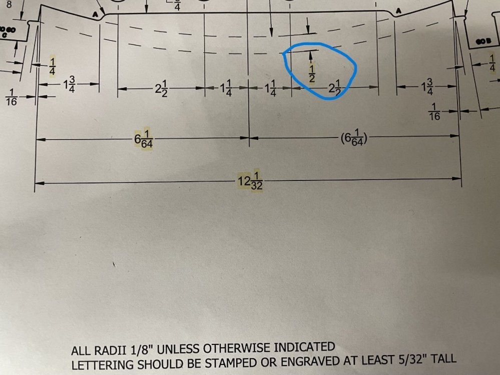

[Ba...] Posted November 8, 2024 Share Posted November 8, 2024 Any help in finding a way to check this 1/2 inch dimension Link to comment https://qualityforum.zeiss.com/topic/4434-new-to-cmm/ Share on other sites More sharing options...
[Ke...] Posted November 8, 2024 Share Posted November 8, 2024 Are the features that are show all that you have to work with? Link to comment https://qualityforum.zeiss.com/topic/4434-new-to-cmm/#findComment-14372 Share on other sites More sharing options...
[Ba...] Posted November 8, 2024 Author Share Posted November 8, 2024 yes Link to comment https://qualityforum.zeiss.com/topic/4434-new-to-cmm/#findComment-14434 Share on other sites More sharing options...
[DW...] Posted November 8, 2024 Share Posted November 8, 2024 Is this a one off job or something you will want programmed? Do you have access to a vision system? Link to comment https://qualityforum.zeiss.com/topic/4434-new-to-cmm/#findComment-14436 Share on other sites More sharing options...
[Ba...] Posted November 8, 2024 Author Share Posted November 8, 2024 Yes i am programing this at lest trying not sure what a vision system is Link to comment https://qualityforum.zeiss.com/topic/4434-new-to-cmm/#findComment-14438 Share on other sites More sharing options...

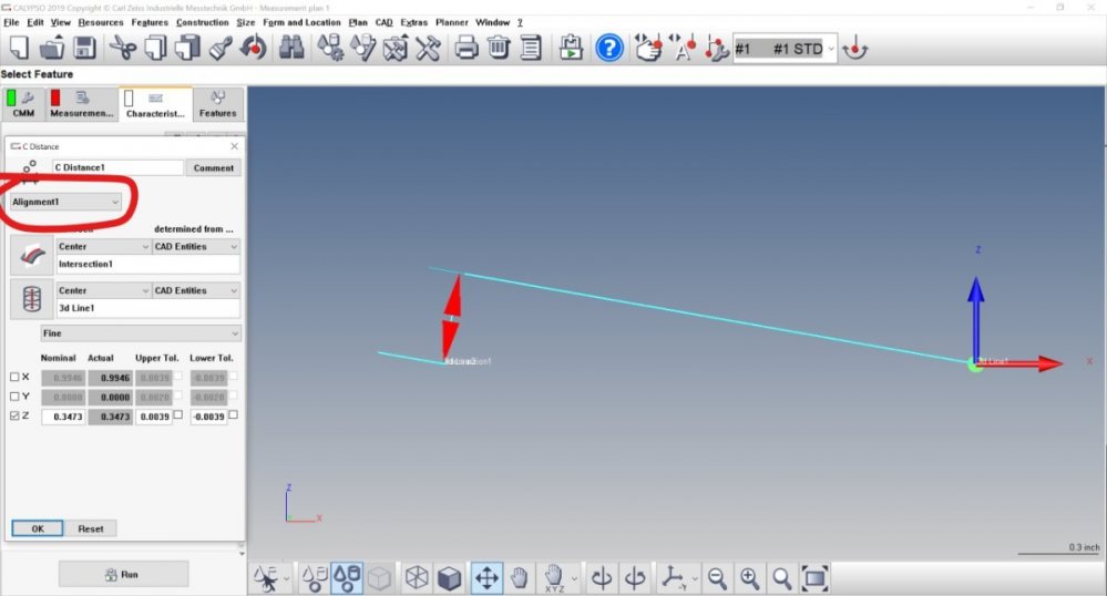

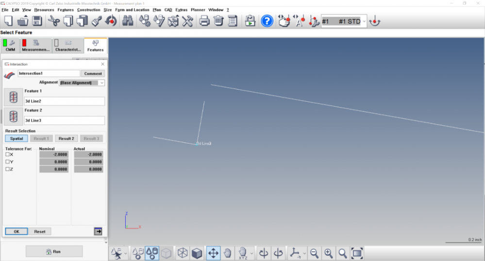

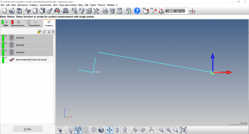

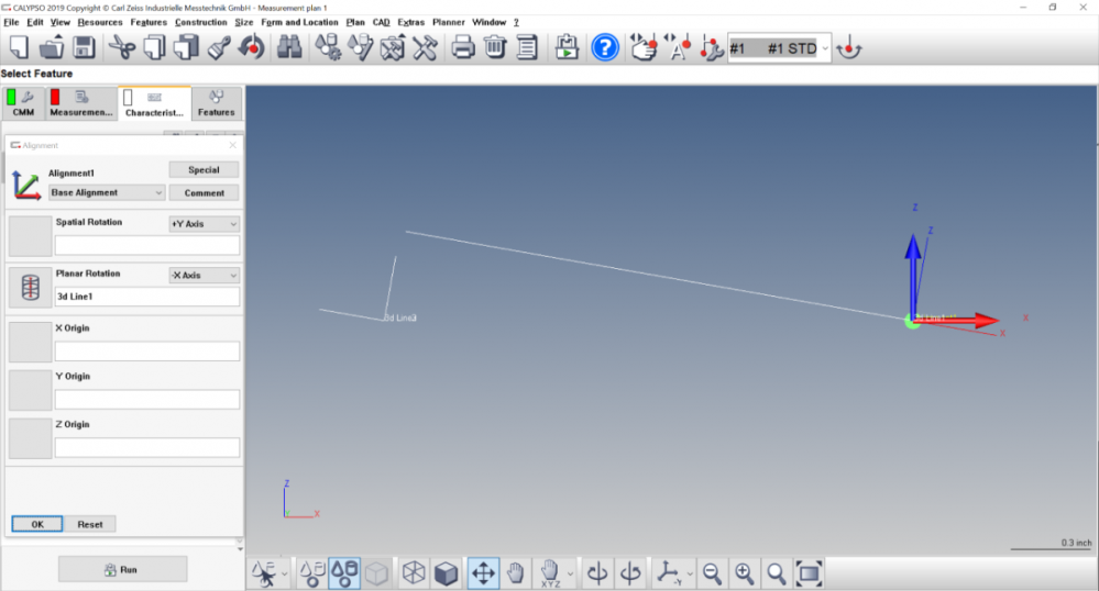

[DW...] Posted November 8, 2024 Share Posted November 8, 2024 This is what I am thinking. Create 3 lines, single points are fine. Then, create an intersection point from the two lines to the left. Create a utility alignment, open it and place the largest line as your planar rotation (keep in mind, probing direction dictates whether it will be plus or minus axis). Leave everything else blank in this utility alignment. Create a caliper distance, going from the intersection to either the center of the clocking line, or create another single point along the line. Make sure in the caliper distance that the new rotated alignment is active. Then select the distance in the respective axis. This should get you in the game. Best of luck. Link to comment https://qualityforum.zeiss.com/topic/4434-new-to-cmm/#findComment-14454 Share on other sites More sharing options...
[Ba...] Posted November 11, 2024 Author Share Posted November 11, 2024 Got it thanks for all your help Link to comment https://qualityforum.zeiss.com/topic/4434-new-to-cmm/#findComment-115588 Share on other sites More sharing options...
