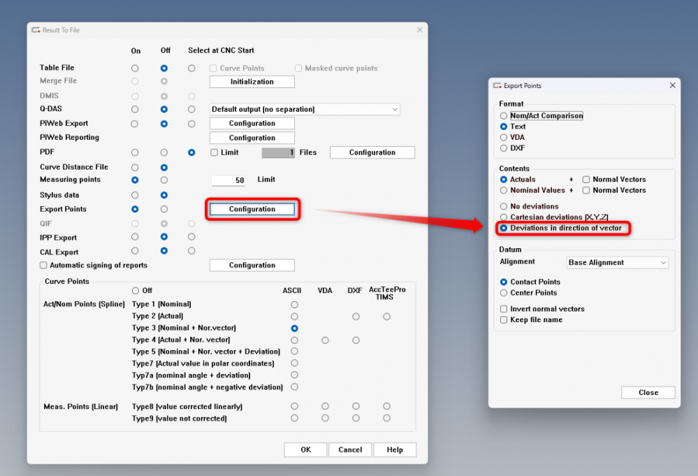

[Mi...] Posted November 7, 2024 Share Posted November 7, 2024 Customer would like to see the Radius of the individual points on the curve (touch points, not scanned) The only way I can think of how to do this is to create individual Feature points and switch to Cylinder Coordinates in Feature Representation. (or export points and do the conversion in Excel) and remeasure the points at the Actuals values from the Curve. Basically measuring the part twice with a lot of typing to create the individual Feature points. I looked in Formulas but nothing jumped out that would work. thanks Link to comment https://qualityforum.zeiss.com/topic/4450-report-individual-points-from-curve-as-radial-distance-instead-of-coordinate/ Share on other sites More sharing options...

[Pa...] Posted January 13, 2025 Share Posted January 13, 2025 Probably too late, but this could be a solution: Link to comment https://qualityforum.zeiss.com/topic/4450-report-individual-points-from-curve-as-radial-distance-instead-of-coordinate/#findComment-124158 Share on other sites More sharing options...
