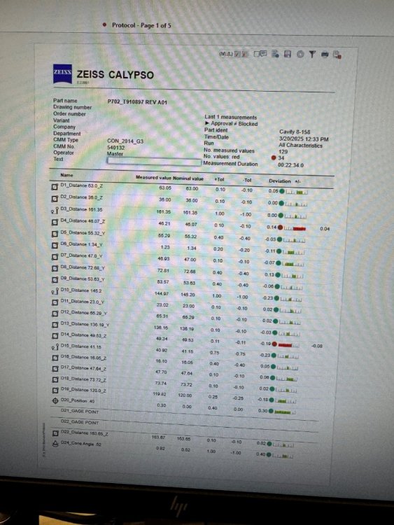

[Lu...] Posted August 18, 2025 Share Posted August 18, 2025 Hello, I think i have a small bug going on and i just wanted to see if anyone has had it before. Sometimes in the report one of the tolerance frames will be missing (i believe it randomly changes the color of it to white, and then when it takes the photo and puts it into a graph the background is also white so it appears missing). is there any known solution? If not then its alright because the graph is still readable without the frames it just makes it a bit easier to read. Ive attatched 2 photos, where one shows what it should look like and the other shows it missing. Thank you! (im on calypso 2021 btw) what it should look like: what it will randomly look like: 1 Link to comment Share on other sites More sharing options...
[An...] Posted August 18, 2025 Share Posted August 18, 2025 Please sign in to view this quote. You need to turn on display plots for PiWeb. Also I actually do not see any CAD evaluations in your screenshot. 1 Link to comment Share on other sites More sharing options...
[An...] Posted August 18, 2025 Share Posted August 18, 2025 Here is a thurough step by step guide on setting the CAD evaluation and then turning it on to display in the PiWeb report. https://portal.zeiss.com/knowledge-base?id=406488 1 Link to comment Share on other sites More sharing options...
