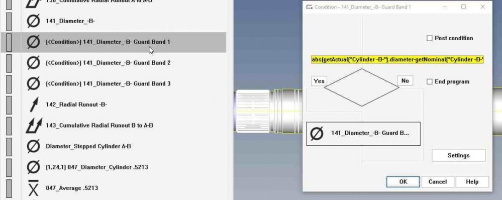

[Pa...] Posted December 12, 2024 Author Share Posted December 12, 2024 I used conditional characteristics. Here's one example of the condition I set. Dwg tolerance is ±.0005, reduced tolerance is ±.00045. 1. create initial feature as normal. Create a Char to evaluate diameter, using full dwg tolerances. 2. Create a second identical feature. Don't recall anything; probe it again in exactly the same way. evaluate it with a diameter char with the reduced tolerance. Do this twice more so you have three separate but identical features; one evaluated to dwg tolerances and two evaluating against the tighter tolerance. All need separate chars. 3. Set a condition on all tighter chars (right click char, select "condition". In the condition window, uncheck Post Condition, paste the following parameter, and move the yes/no around until "yes" points to the char. Parameter: abs(getActual("-B-").diameter-getNominal("-B-").diameter)>0.0009 Expected behavior: CMM probes -B- Condition runs. If B's diameter meets both tolerances, none of the other features called by these conditional chars ("Guard Band" in my screenshot) will be probed. If B's diameter fails either or both tolerances, CMM will probe the feature again 3 times, reporting diameters for all 4 probings. Warning limits change colors only. They don't impart any control whatsoever. We tried that. There are no operators who will get it right when left alone. Obviously, much of this can be changed to suit varying needs. Link to comment https://qualityforum.zeiss.com/topic/4648-rerun-feature-if-characteristic-is-oot/#findComment-122536 Share on other sites More sharing options...
[Pa...] Posted December 12, 2024 Author Share Posted December 12, 2024 Sorry. In step 2 I miscounted. Should have 4 identical features, three evaluated against the tighter tolerance. Link to comment https://qualityforum.zeiss.com/topic/4648-rerun-feature-if-characteristic-is-oot/#findComment-122538 Share on other sites More sharing options...
