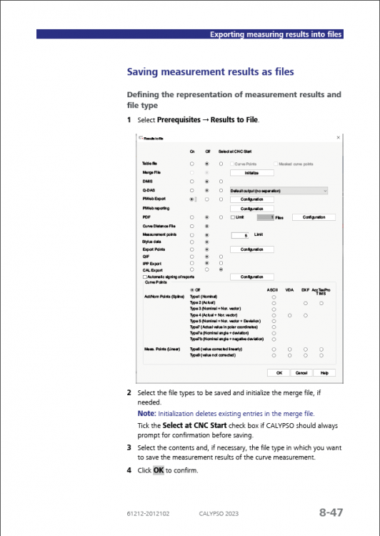

[Th...] Posted September 27, 2024 Share Posted September 27, 2024 Moin Zusammen, wenn ich eine Mehrfachmessung (Palette) starte (bspw. 100 identische Bauteile) bekomme ich auch 100 Excel Dokumente am Ende heraus. Ist es irgendwie möglich, diese 10 Messergebnisse gesammelt in nur einem Excel Dokument ausgegeben zu bekommen? Das würde mir ein späteres Zusammenlisten und somit viel Zeit sparen. Danke und mit freundlichem Gruß, Thomas Link to comment https://qualityforum.zeiss.com/topic/4726-excel-sammeldatei-in-calypso/ Share on other sites More sharing options...

[Ma...] Posted October 1, 2024 Share Posted October 1, 2024 Please sign in to view this quote. Geht irgenwie nicht 😮 Link to comment https://qualityforum.zeiss.com/topic/4726-excel-sammeldatei-in-calypso/#findComment-14862 Share on other sites More sharing options...
[To...] Posted October 1, 2024 Share Posted October 1, 2024 Please sign in to view this quote. Turn on Table Files and activate Merge Files Link to comment https://qualityforum.zeiss.com/topic/4726-excel-sammeldatei-in-calypso/#findComment-14864 Share on other sites More sharing options...
[Th...] Posted April 1, 2025 Author Share Posted April 1, 2025 Please sign in to view this quote. Wo finde ich das? Link to comment https://qualityforum.zeiss.com/topic/4726-excel-sammeldatei-in-calypso/#findComment-129387 Share on other sites More sharing options...
[Ma...] Posted April 1, 2025 Share Posted April 1, 2025 Please sign in to view this username. Link to comment https://qualityforum.zeiss.com/topic/4726-excel-sammeldatei-in-calypso/#findComment-129391 Share on other sites More sharing options...
[Th...] Posted April 1, 2025 Author Share Posted April 1, 2025 Danke 👍 Link to comment https://qualityforum.zeiss.com/topic/4726-excel-sammeldatei-in-calypso/#findComment-129393 Share on other sites More sharing options...
