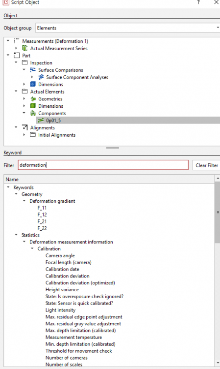

[He...] Posted October 18, 2021 Share Posted October 18, 2021 Hi. I just wondering why the Green strain values calculated by the deformation gradient and stretch ratio(at GOM GUI) are different. the deformation gradient of each facet are extracted by the automation coding with pyautogui, and the stretch ratio are extracted by using Python script imbedded in GOM. After I read the manual of the gom, I thought the 'stretch ratio' at GOM GUI,,, you know,,, surface inspection GUI,,,, comes from U (right stretch ratio), but actually, the stretch ratio from the right stretch tensor and surface inspection GUI stretch ratio are different. Can you tell me the reason why this difference is happened? Thanks. Link to comment https://qualityforum.zeiss.com/topic/487-sorry-for-repost-it-again-deformation-gradient-vs-stretch-ratio/ Share on other sites More sharing options...
[Iv...] Posted November 1, 2021 Share Posted November 1, 2021 Hello, i didn't quiet understand your point. Can you be more precise? Which inspection is different? Every strain inspection is based on the stretch tensor. Greetings, Ivan Link to comment https://qualityforum.zeiss.com/topic/487-sorry-for-repost-it-again-deformation-gradient-vs-stretch-ratio/#findComment-1534 Share on other sites More sharing options...
