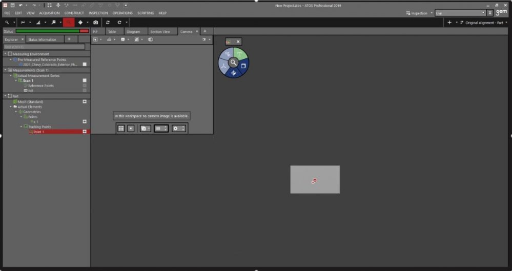

[Ab...] Posted October 20, 2021 Share Posted October 20, 2021 I am using ATOS PRofessional 2019 What I am trying to do? I have an object with two parts (1 part moves and the other part doesn't) with targets (circular black and white dots) stuck on to them. I put one particular target on the moving part --> I scan one patch --> then i move the moving part vertically up for 50mm --> I take another scan for the same particular target Problem: When I move the moving object vertically up, I am not sure if I place it at 50mm vertical exactly- I cannot use any measuring devices to check that exactly- I can get it closer to 50mm but not exactly 50mm. What I am looking for - I need to know if there is a setup on ATOS professional that would allow me to view the live distance measurement of a particular target point as I move the object with the scanner facing it. Please do let me know if you have any ideas/ suggestions with respect to the capability of the ATOS Professional software/hardware setup. Thank you. Link to comment https://qualityforum.zeiss.com/topic/490-atos-scanner-can-show-live-measurements-between-target-points-when-scanning/ Share on other sites More sharing options...
[Na...] Posted October 21, 2021 Share Posted October 21, 2021 Hello, it is possible to track a reference point or a point component out of several reference points in the "Live" workspace in the software. There is an eLearning in the gom training center: https://training.gom.com/course/45064 Maybe the direct help for the tracking point is sufficient in this case: https://techguide.gom.com/en/article/cmd_inspection_measure_by_online_tracking_point.html Regards, Nanno Link to comment https://qualityforum.zeiss.com/topic/490-atos-scanner-can-show-live-measurements-between-target-points-when-scanning/#findComment-1485 Share on other sites More sharing options...
[Ab...] Posted October 21, 2021 Author Share Posted October 21, 2021 Please sign in to view this username. Thank you. I tried following - https://techguide.gom.com/en/article/cmd_inspection_measure_by_online_tracking_point.html I created a tracking point from construct option on inspection pane --> But the measuring principle is not activated to select the tracking point as per https://techguide.gom.com/en/article/cmd_inspection_measure_by_online_tracking_point.html Kindly requesting your assistance, is there anything I am missing that doesn't show me the option? Link to comment https://qualityforum.zeiss.com/topic/490-atos-scanner-can-show-live-measurements-between-target-points-when-scanning/#findComment-1487 Share on other sites More sharing options...
[Na...] Posted October 22, 2021 Share Posted October 22, 2021 Hello, the tracking function is available in the workspace "Live" with the camera symbol: Regards, Nanno Link to comment https://qualityforum.zeiss.com/topic/490-atos-scanner-can-show-live-measurements-between-target-points-when-scanning/#findComment-1493 Share on other sites More sharing options...
[Ab...] Posted October 25, 2021 Author Share Posted October 25, 2021 Please sign in to view this username. Thank you for your support. I did try that. However, I dont see any measurements when I move the point- It just says tracking point is active but it doesn't show any measurements. Do you think I am doing something wrong? Link to comment https://qualityforum.zeiss.com/topic/490-atos-scanner-can-show-live-measurements-between-target-points-when-scanning/#findComment-1506 Share on other sites More sharing options...
