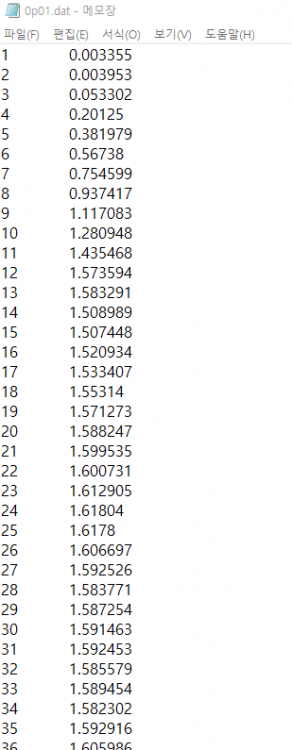

Actually, I tried many times to import load data, but I got a message, 'The project contains measurements or a VMR'
the Import files are ASCII format, posted below capture.
Thanks.
Hello Heonyong Lim,
probably you tried to import the file using the "New Part" method. Here you have to use "Add to part" or "Replace in part".
Regards,
Daniel Schrein
