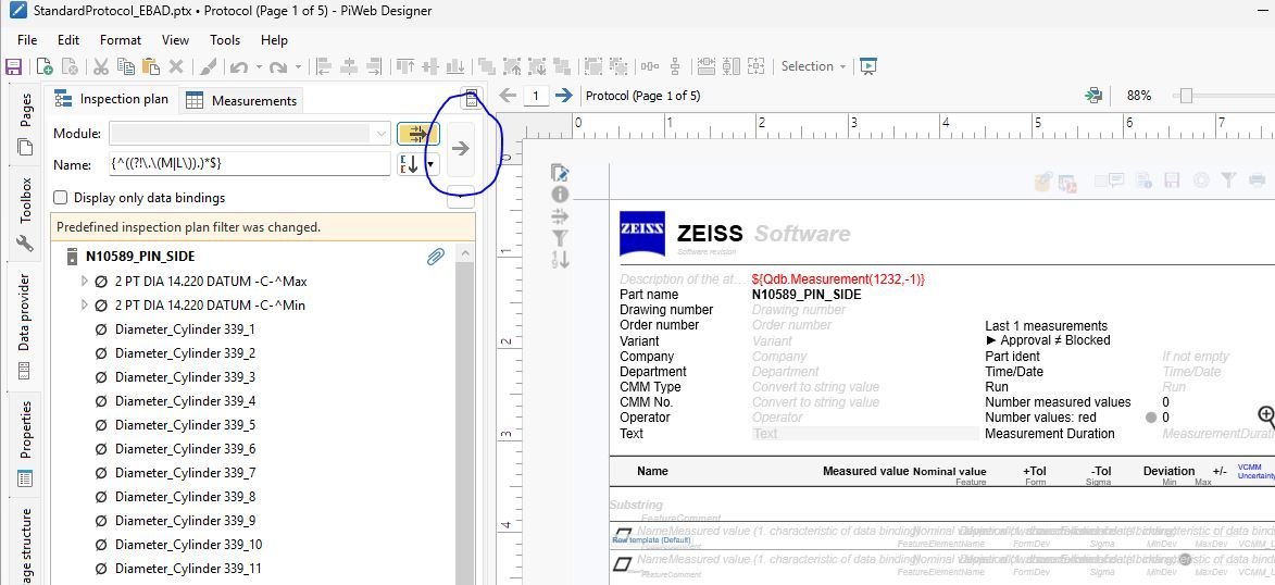

[To...] Posted July 17, 2024 Share Posted July 17, 2024 I am reporting true positions with "Additional Report" active to show X and Y locations. Then, I am using a Best Fit Bore Pattern position in order to have a plot of the hole positions. Unfortunately, this also includes the position results a 2nd time. Previously, I have eliminated lower tiered results on other characteristics but I don't recall the nitty gritty details. I assume I can eliminate the 4 lines shown in the red square but need some help. TIAScreenshot 2024-07-17 150028.jpg Link to comment Share on other sites More sharing options...
[An...] Posted July 18, 2024 Share Posted July 18, 2024 Hi Tom, If you want to remove those 4 lines, try using this Regex in the name filter: ^[^\^]+$ If that does not work, try this regex: (?<!^[^\^]+)$ Link to comment Share on other sites More sharing options...
[To...] Posted July 18, 2024 Author Share Posted July 18, 2024 Please sign in to view this quote. Thank you Andy. Any chance you could be more specific on the steps involved? It doesn't need to be as thorough as the one I did about a year ago....lol To be honest, I don't remember if I finished this.Customize Plot Protocol with Mean Deviation of Line Profile.pdf Link to comment Share on other sites More sharing options...
[An...] Posted July 22, 2024 Share Posted July 22, 2024 Hi Tom, Sorry I took so long in getting back to you on this. Things blew up on my end last week. You should enter this in the Name Filter of the PiWeb report found in the Data Provider tab. You can enter it on either PiWeb Designer or PiWeb Monitor. In order to use it in PiWeb Monitor, you need to ensure that the "Characteristic Selection in PiWeb Monitor" checkbox is selected, as the field is not present unless that option is checked. Link to comment Share on other sites More sharing options...

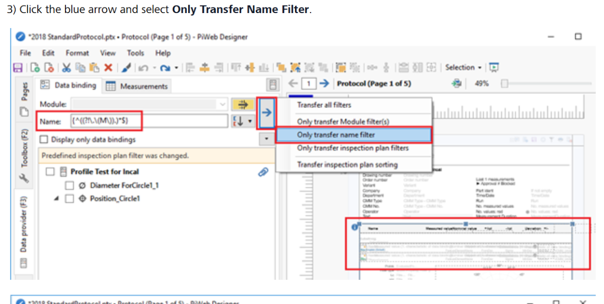

[Ky...] Posted July 23, 2024 Share Posted July 23, 2024 Hello Tom and Andy, I hate to drop in, because everything that Andy said is correct, I just wanted to point out that the filtering is covered in the knowledge base article on getting rid of the .M characteristic (https://portal.zeiss.com/knowledge-base?id=458620). Perhaps we should have another article specifically on filtering.... Regardless, as Andy alluded to, the filtering uses regular expressions which are pretty difficult to understand sometimes. For those coming along after, I have had good luck using this site to test and debug my regular expression code: https://regex101.com/. I have had to do something similar to filter out everything but jpg files for Gear Pro reports before and that made it much easier. 1 Link to comment Share on other sites More sharing options...
[Ze...] Posted November 17, 2025 Share Posted November 17, 2025 This is not working. The blue arrow isn't selectable and the option to transfer the name filter is not available. The entries change below and remove the M entries but there is no options to transfer filters. Using Calypso 2024 7.8.12 SP3 Link to comment Share on other sites More sharing options...
[Ze...] Posted November 17, 2025 Share Posted November 17, 2025 You should put in the instructions for step 3 that you need to highlight the report element again before it shows the option to transfer the file name filter. This seems overly complicated to remove a simple dimension entry. Link to comment Share on other sites More sharing options...
