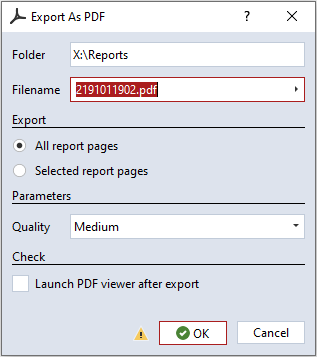

Hi Erik
Thanks for the script ?
I have two questions I hope you can help me with
1. when I run the script I get this dialog box
Is it possible to approve (ok) it automatically?
2. If there is no folder with similar project name (file name) like the one the scrip is trying to save, is it then possible to get the script to make a new folder?
something like this: os.makedirs( export_path )
