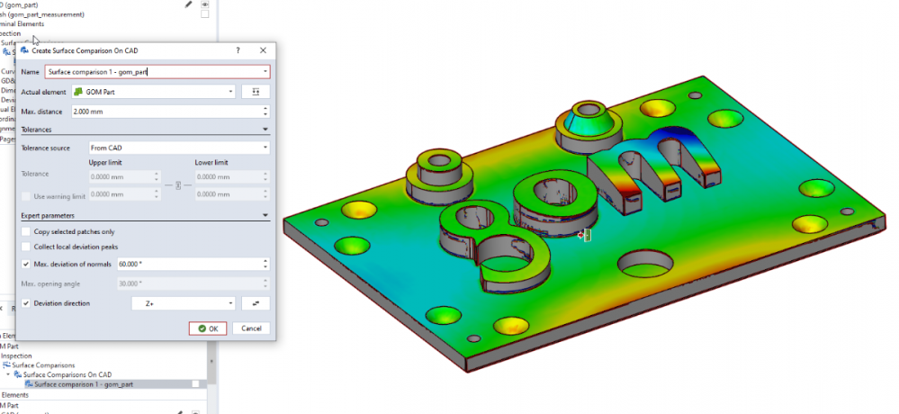

[Mi...] Posted November 10, 2021 Share Posted November 10, 2021 is it possible to plot a surface comparison in only a given direction? example - i want to plot only the z-component in the comparison. thank you. Link to comment Share on other sites More sharing options...
[Na...] Posted November 11, 2021 Share Posted November 11, 2021 Hello Michael, there is the "Deviation direction" under the expert parameters of a surface comparison: Regards, Nanno Link to comment Share on other sites More sharing options...
