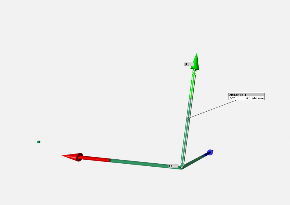

[Hu...] Posted January 20, 2021 Share Posted January 20, 2021 Hi, I am fairly new to GOM correlate. I am doing a biomechanical fracture study, where we used reference marks on both sides of the fracture. The aim is to calculate the displacement of the fracture. I am only interested in the displacement in XY-plane and not in all XYZ. Is it possible to do an conversion from 3D to 2D in GOM correlate? Can i somehow find the common rotation axis? The plan right now is to export the XYZ coordinates to excel and then do the post-processing in another software. Thanks! Link to comment https://qualityforum.zeiss.com/topic/55-3d-coordinates-conversion-to-2d/ Share on other sites More sharing options...

[Iv...] Posted January 25, 2021 Share Posted January 25, 2021 Hi Huda, there are different ways to convert 3D coordinates into a 2D coordinate. For example create them as a projection point onto the plane you like to inspect or exporting the image series and only import the series from one of the two cameras. But i would recommend to stay in the 3D volume because you will generate mistakes while inspecting only in 2D. Check the webinar for types of mistakes https://www.youtube.com/watch?v=pGXuXg7dRlo You can check all of the displacement in the directions you like to. If you are only interested in the displacement in X and Y-direction inspect only this displacements with the GOM Correlate. The results you will receive, is the X or Y proportion of the displacement of your component based on the alignment of your project. I hope these are the results you like to receive. Greetings, Ivan Link to comment https://qualityforum.zeiss.com/topic/55-3d-coordinates-conversion-to-2d/#findComment-149 Share on other sites More sharing options...

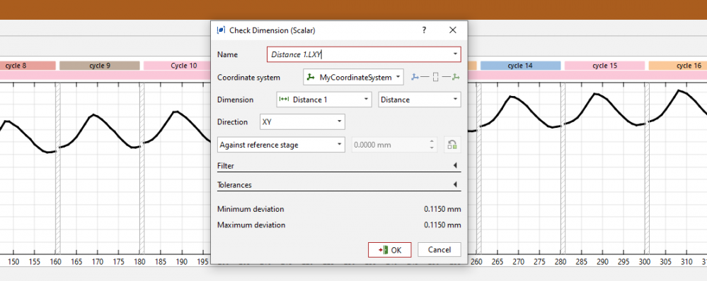

[Hu...] Posted January 28, 2021 Author Share Posted January 28, 2021 Hi Ivan, Yes, that does make sense. I will try to do the data processing in GOM correlate. The reason why I don't want the Z-direction is that i corresponds to the depth of the fracture - which I am not interested in for now. I decided to create a local coordinate system in GOM correlate and then project the points onto the XY-plane: 1. Created a local coordinate system through 3-2-1 alignment 2. Create points on the reference markers 3. Construct distance between the desired points and I chose XY-direction on my coordinate system. Is this the right workflow? or is there a more accurate/efficient way to do this? I find it hard to find tutorials and manuals for working with point components and not surface components. Again, thank you for the help ? ! BR, Huda Link to comment https://qualityforum.zeiss.com/topic/55-3d-coordinates-conversion-to-2d/#findComment-180 Share on other sites More sharing options...
