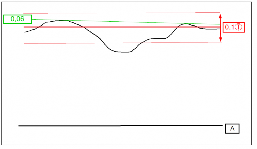

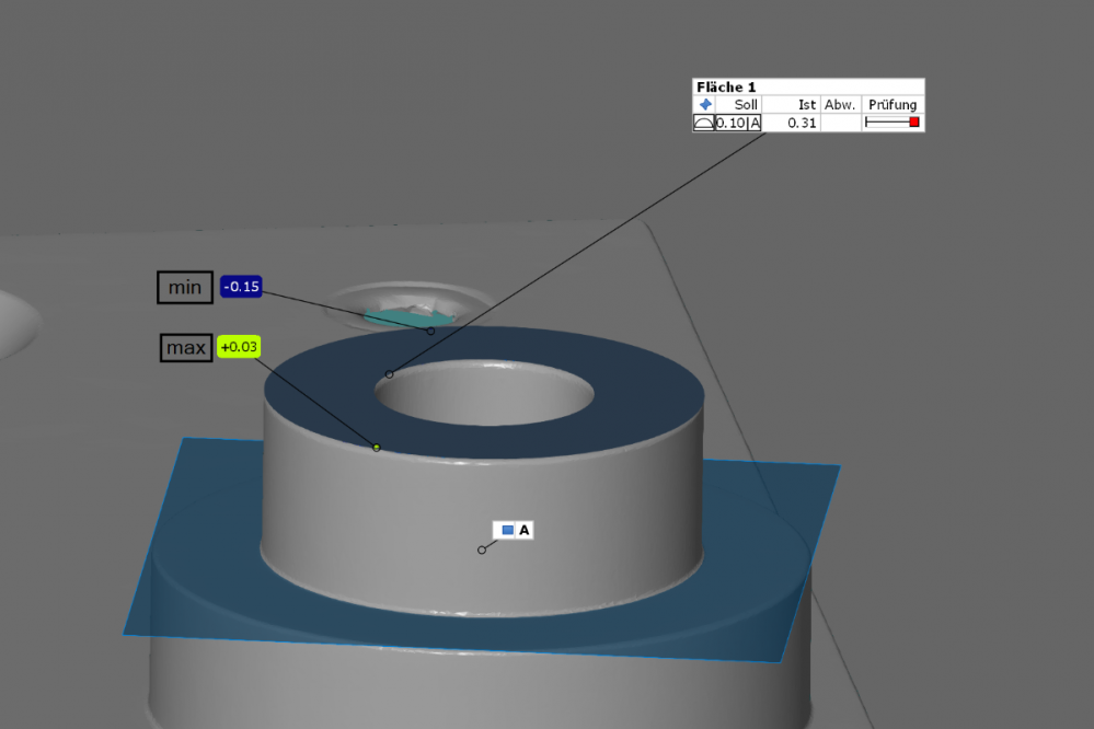

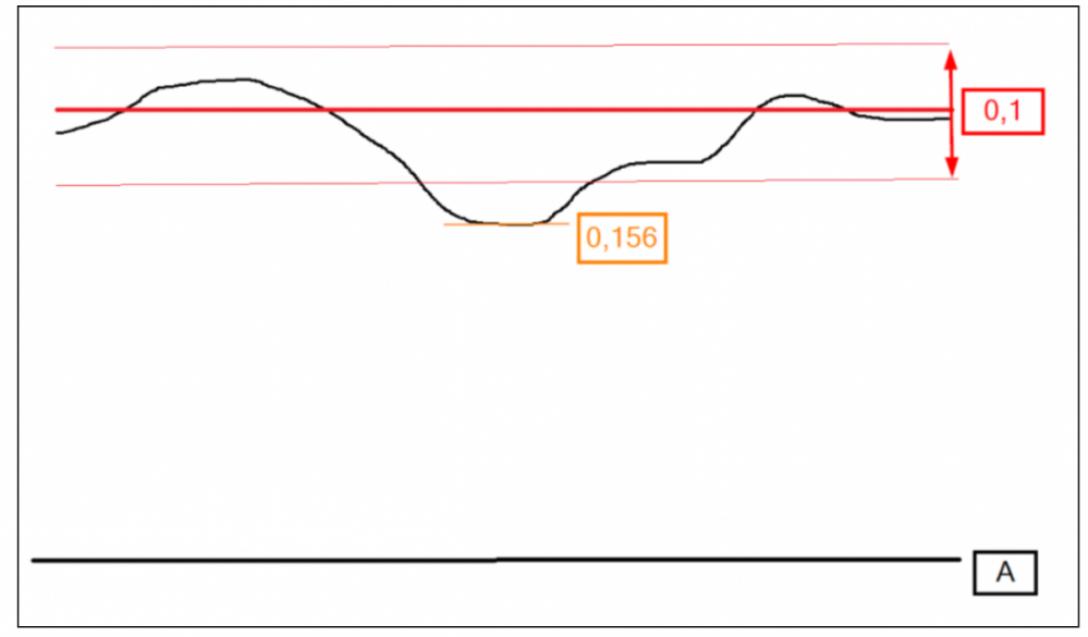

[Da...] Posted November 17, 2021 Share Posted November 17, 2021 Hi, I would like to specifiy the height of a step like shown in the picture below: GOM is showing the biggest deviation of the surface: min:0,156 -> Profile form of 0,31 See interpretation: But for function of the part, I would just need the tangential deviation Ⓣ (which is described in ISO 1101:2017) and I do not care about the lower deviation. See interpretation: Is there an option or a workaround to evaluate this specification in the GOM Inspect software? Thanks! Link to comment Share on other sites More sharing options...

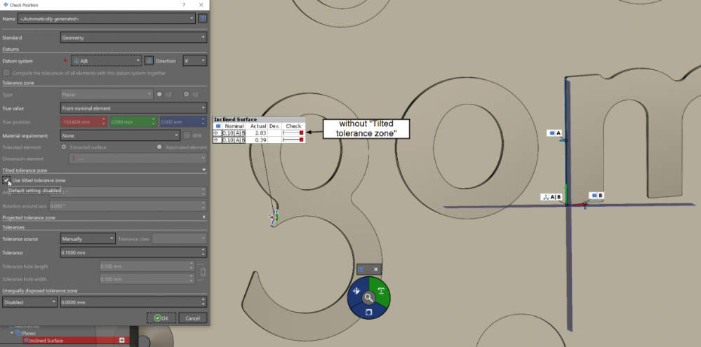

[Da...] Posted November 17, 2021 Author Share Posted November 17, 2021 Many thanks for this workaround! That approach works well, but it would be great if this features are implemented in a new software version! Unfortunately, the position tolerance is only working surfaces that are parallel to the datum. For inclined surfaces I have to activate the option "tilted tolerance zone". Are there any limitations or disadvantages to using this option? Thanks again! Link to comment Share on other sites More sharing options...
[Ch...] Posted November 18, 2021 Share Posted November 18, 2021 Hello, of course this feature is on our list (unfortunately this is not the only one so that we cannot say to which version we can include this one). Regarding "tilted tolerance zone", of course you can enable this feature if you have specified angle between your plane and your datum. This is the main application for this option so please be free to use it. Best regards Christoph Schult Link to comment Share on other sites More sharing options...
