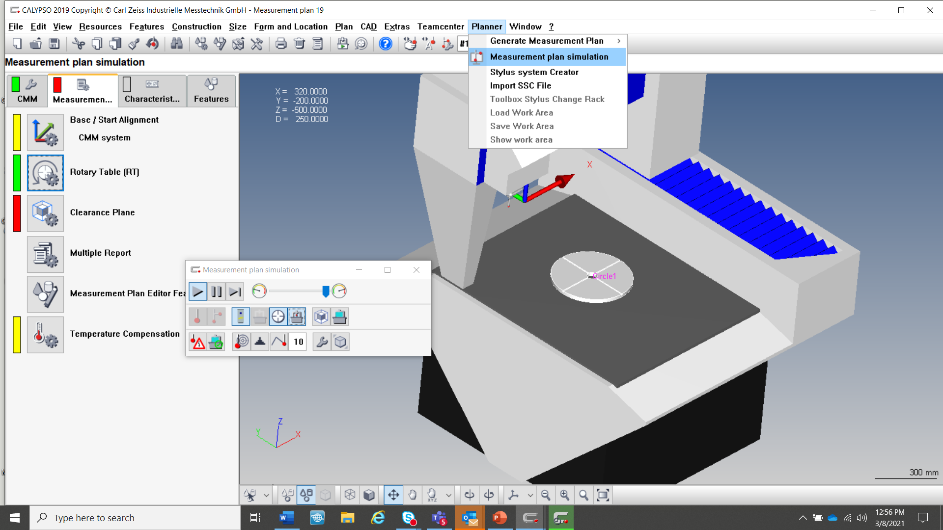

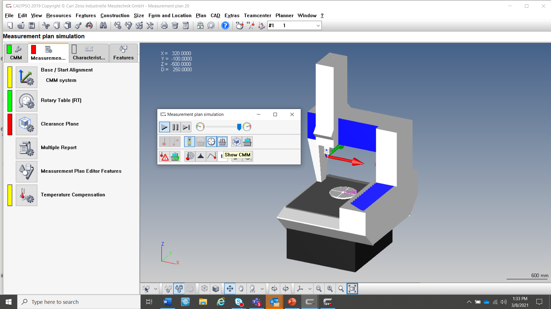

[M1...] Posted June 4, 2025 Share Posted June 4, 2025 Does anyone have some good instructions on how to use RT in simulation, because the workpiece is almost always way off from the center of the RT when simulating a run. I can´t accesss the knowledge base. Link to comment https://qualityforum.zeiss.com/topic/5710-rotary-table-in-simulation/#findComment-133163 Share on other sites More sharing options...

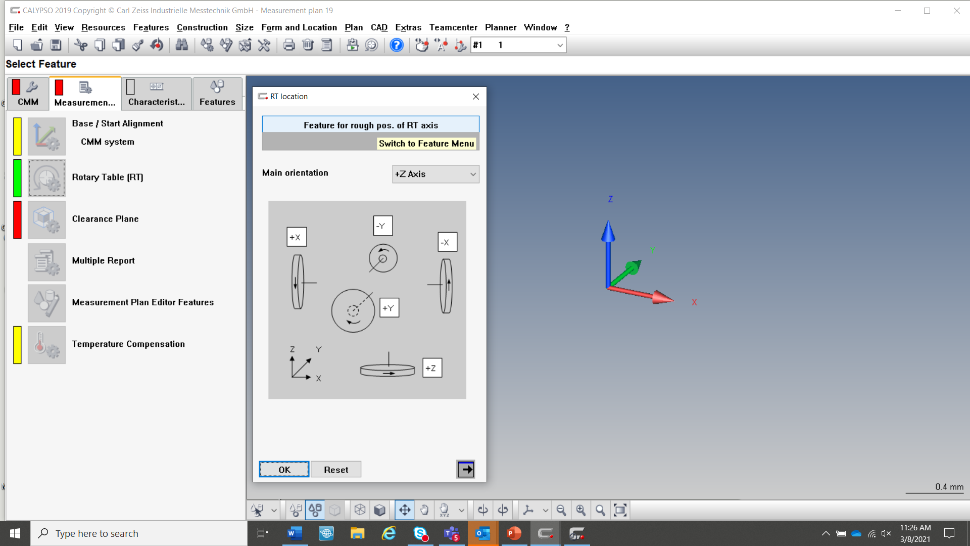

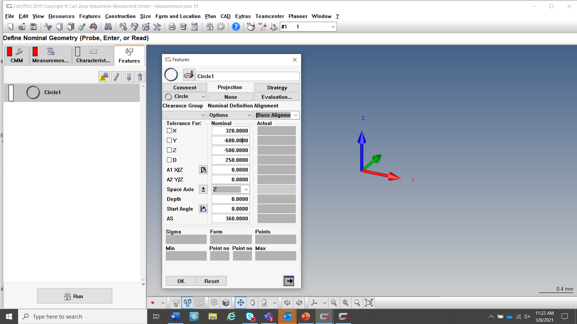

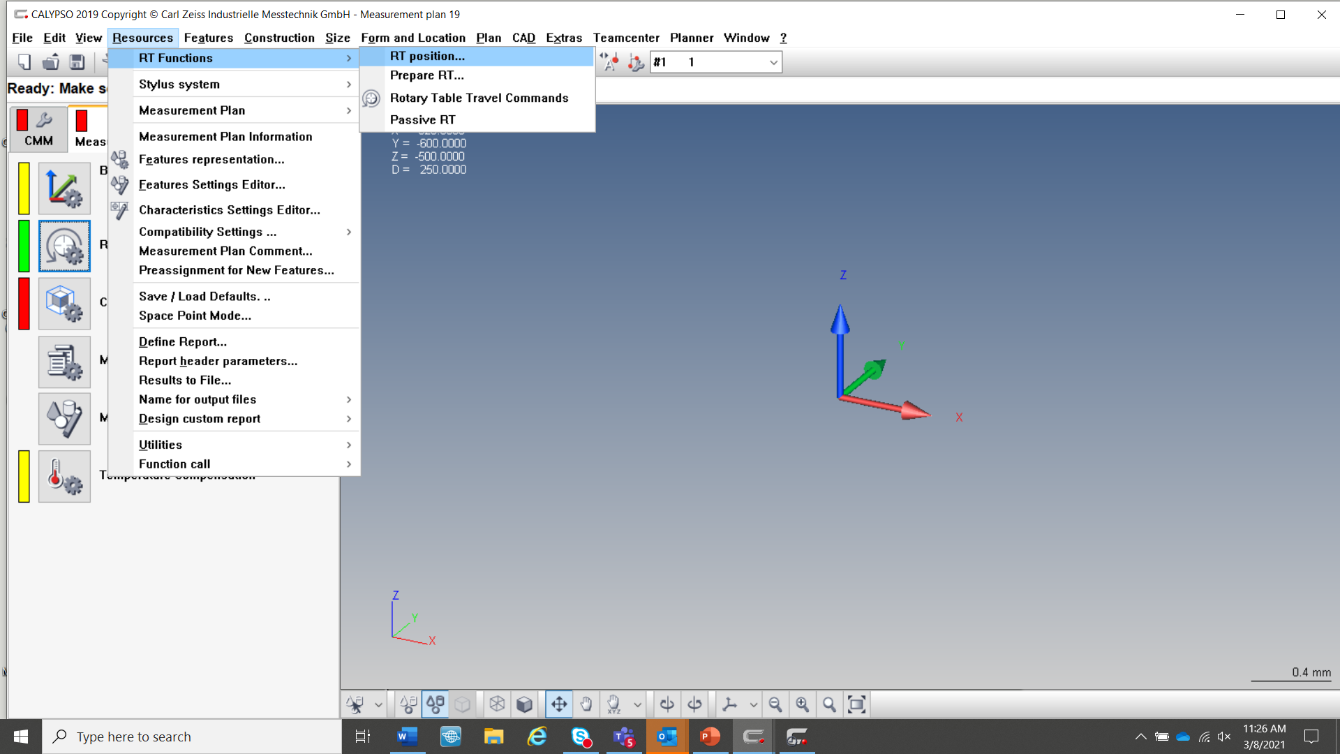

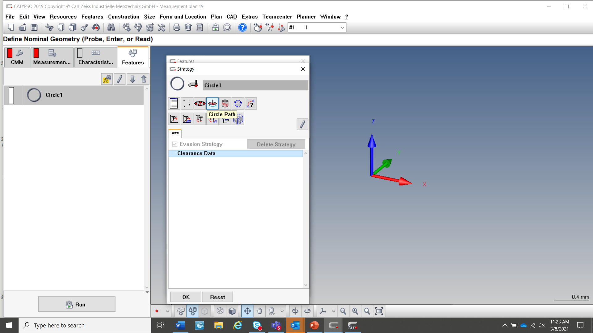

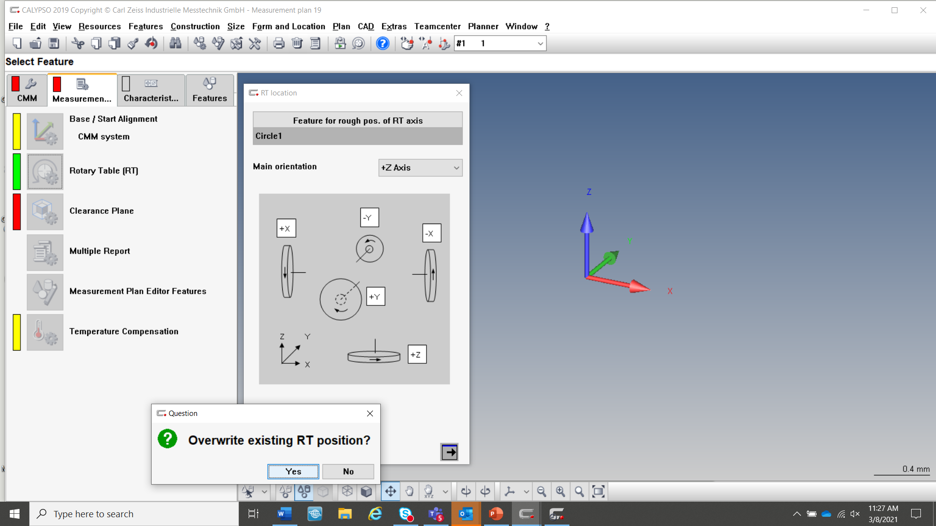

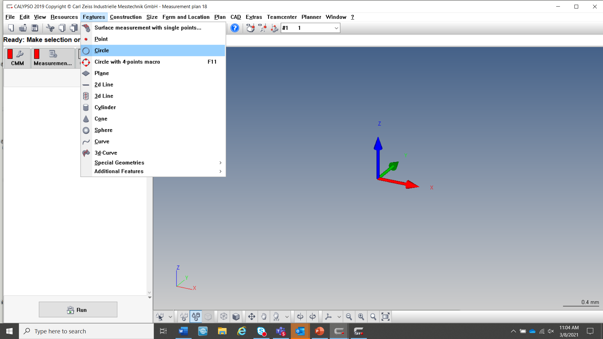

[Ri...] Posted June 4, 2025 Share Posted June 4, 2025 CALYPSO Planner/Simulation: How to Locate the Rotary Table Written by Robert Bala This Document Focuses on How to Update the Location of the Rotary Table Step 1: Launch CALYSPO. Step 2: Go under Extra, setting, and then CMM Step 3: Choose the machine that has the set-up ready for the Rotary table Step 4: Check “Simulation” and click “Connect” Step 5: Minimize the traffic light dialog box. Step 6: Open a new measurement plan. Step 7: Activate the Feature tab and from the Menu, select “Features”, then choose “Circle” Step 8: Double click the “Circle”, and enter nominal data 320 for X, -200 for Y, -500 for Z, and 250mm for the diameter D Step 9: Double click “Strategy” Step 10: Single click on the “Circle Path” and click “OK” Step 11: Click the “Measurement” tab, and double click “Rotary Table (RT)” Step 12: Check “RT activated for this measurement plan” Step 13: Then, click “OK” Step 14: Select "Resources", navigate to "RT Functions", then choose “RT position...” Step 15: Click on “Feature for rough pos. of RT axis” Step 16: Choose “Circle1” and keep the z-axis, and then click “OK” Step 17: Choose “Yes” to overwrite the existing RT position. Step 18: Double click the Rotary Table icon, again. Step 19: check “RT activated for this measurement plan” Step 20: Then, click “OK” Step 21: Select Planner from the toolbar Menu, turn on “Measurement plan simulation.” Step 22: Then, click the “show CMM” icon. RESULTS: Notice that the location of the rotary table is at y= -200mm. If for some reason the table is not centered, or you need to move it, see below: There is a readable file called “rotarytableaxis_sim” is in the directory: (C:\Users\Public\Documents\Zeiss\CALYPSO\workarea\basesystems) Open the file up with notepad and modify the “#vector” (x,y,z) values to position the table. The “#DirectionVector” (x,y,z) values should be set to (0,0,1). You might also need to position the part CAD file in the normal positioning method. I would use the same X,Y,Z offset values that the RT is set to and then everything should line up. 1 Link to comment https://qualityforum.zeiss.com/topic/5710-rotary-table-in-simulation/#findComment-133185 Share on other sites More sharing options...
[Ro...] Posted July 6 Share Posted July 6 I have tried this, and feel I am doing something wrong, as I cannot get the rotary table position to change, after changing the vector as described. Link to comment https://qualityforum.zeiss.com/topic/5710-rotary-table-in-simulation/#findComment-152481 Share on other sites More sharing options...
[Ca...] Posted July 9 Share Posted July 9 Is it placing the RT in the location of the circle you are creating? If so, you may need to change the values for the circle to better match where you want it on the table (Step 8). 1 Link to comment https://qualityforum.zeiss.com/topic/5710-rotary-table-in-simulation/#findComment-152665 Share on other sites More sharing options...
[Ro...] Posted July 9 Share Posted July 9 The RT moves, when I select the circle, in the location I desire. I then get invalid axis. I click on Rotary Table, under the measurement tab, and it snaps back to where it was. Changing the dimensions in that file does nothing either. I ended up just ignoring it, and moving on with what I needed to get done. Link to comment https://qualityforum.zeiss.com/topic/5710-rotary-table-in-simulation/#findComment-152683 Share on other sites More sharing options...
