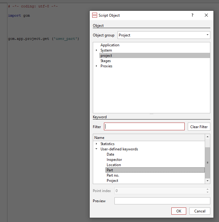

[ca...] Posted December 16, 2021 Share Posted December 16, 2021 Hello everyone, I want to learn if it is possible or not to export project keywords and write on a .txt file or at least, to access the keywords as parameters. We use project keywords (which includes some info about part number, serial number, inspector info etc.) in every part is scanned and inspected. Therefore, in our script, we need to use project keywords filled by inspector in a separate file (as marking tag of the part). Is there a way to do that? Many thanks, Canset Link to comment https://qualityforum.zeiss.com/topic/602-exporting-project-keywords-in-a-txt-file/ Share on other sites More sharing options...
[Mi...] Posted December 17, 2021 Share Posted December 17, 2021 (edited) Canset, I've recently begun utilizing project keywords in our scan templates as well (they've proven particularly handy for autofilling information on report pages!). You can access project keywords in the Script Editor by right-clicking and selecting Insert--> Element Value (or hitting F2 as a keyboard shortcut). In the window that appears, select the Project Object group, and "project" in the list, then in the keyword window at the bottom click on "User-defined keywords" to access all the available project keywords. In the screenshot below I've inserted the "Part" keyword, and it appears in the script as the "gom.app.project.get ('user_part')" string variable. From here you could use standard python open/write methods to write the keyword variables to a text file in whatever format you choose. I hope this helps! Regards, Michael EDIT: I should point out that this method works for at lease ATOS V8 through 2020, we haven't updated to ATOS 2021 so I don't know if the Script Editor interface has changed significantly in that version. Edited December 17, 2021 Link to comment https://qualityforum.zeiss.com/topic/602-exporting-project-keywords-in-a-txt-file/#findComment-1822 Share on other sites More sharing options...
[ca...] Posted December 20, 2021 Author Share Posted December 20, 2021 Hello Michael, We also need project keywords both for reporting purposes and use .txt files for kind of separate tag file of the part. Actually after creating this subject, I accessed and edit the keyword variables through script.(gom.sys.set_project_keywords). However, your way of accessing element values looks like much more useful. Many thanks for your help, Canset Link to comment https://qualityforum.zeiss.com/topic/602-exporting-project-keywords-in-a-txt-file/#findComment-1825 Share on other sites More sharing options...
