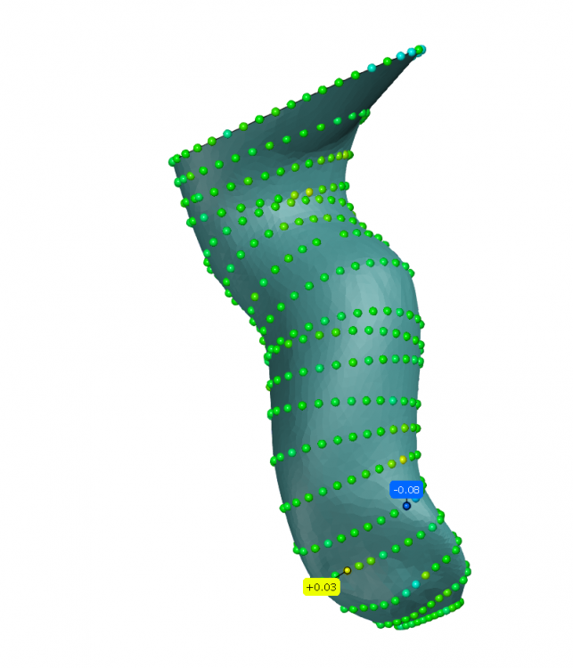

[Ti...] Posted January 6, 2022 Share Posted January 6, 2022 Is there a way to get the shortest distance from point cloud to a surface? The point cloud points are from an ITU standard and the surface I created to try and match the standard. the inspect file is attached Any help is very appreciated Timm 2141555225_ITUP57Ear.ginspect Link to comment https://qualityforum.zeiss.com/topic/626-inspection-point-cloud-to-step-file-surface/ Share on other sites More sharing options...
[Ch...] Posted January 7, 2022 Share Posted January 7, 2022 Dear Timm, you can create a Surface Comparisson an Actual, select the desired Points in the 3D view and use as nominal Element the desired surface (e.g. a CAD or nominal surfaces). adjust the max (search) distance to nour needs. If you now switch to I-Inspect you can check this comparisson for min/max deviation. Hope this helps. BR Christine Link to comment https://qualityforum.zeiss.com/topic/626-inspection-point-cloud-to-step-file-surface/#findComment-1881 Share on other sites More sharing options...
[Ti...] Posted January 9, 2022 Author Share Posted January 9, 2022 Please sign in to view this username. Thank you for the help! That is exactly what I was looking for. Link to comment https://qualityforum.zeiss.com/topic/626-inspection-point-cloud-to-step-file-surface/#findComment-1883 Share on other sites More sharing options...
