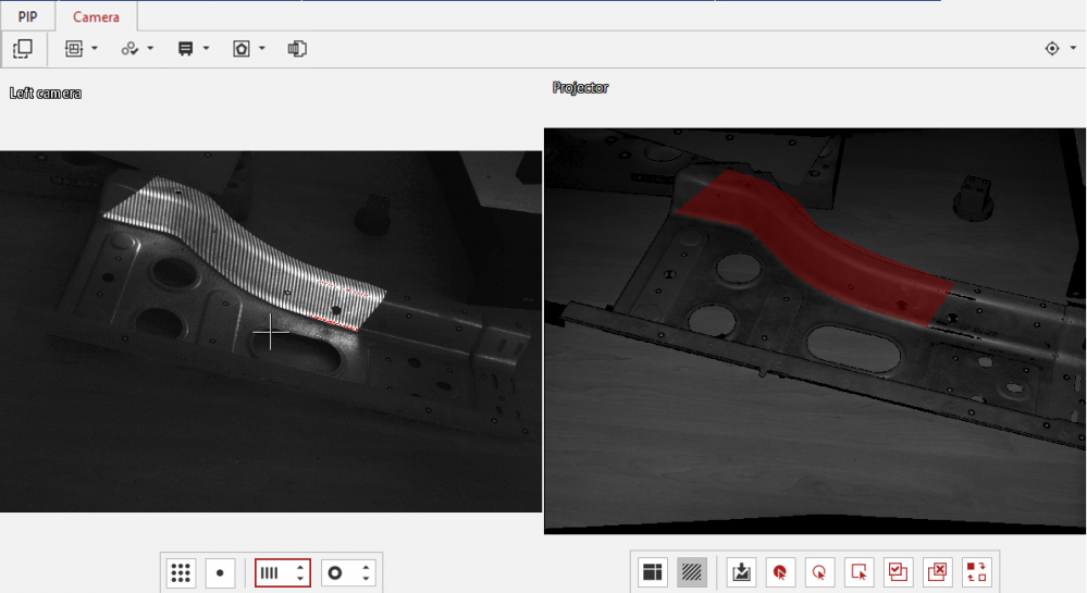

[Zi...] Posted January 11, 2022 Share Posted January 11, 2022 Hi, GOM software proposes Define Scan Area Manually to deal with sheet metals with double reflections, the user just needs to define manually a zone on the virtual projector image and the sensor then projects light only on this zone, as the figure below. I am curious about this virtual projector image which seems not to be a camera image, can anyone tell me how this projector image is generated and how it is mapped to the 3D scene? And if is possible to get this image with Python script? Best regards Zilong SHAO Link to comment https://qualityforum.zeiss.com/topic/636-virtual-projector-image-with-scan-mode-define-scan-area-manually/ Share on other sites More sharing options...
[Na...] Posted February 28, 2022 Share Posted February 28, 2022 Hello, I think the right image is a simulated image from the view point of the projector. Similar to the function "Rotate 3D View to Sensor" while scanning. The image is then an overlay with some distortion to fit the point of view from the projector. I'm not aware of a way to extract the image from this view. Regards, Nanno Link to comment https://qualityforum.zeiss.com/topic/636-virtual-projector-image-with-scan-mode-define-scan-area-manually/#findComment-2201 Share on other sites More sharing options...
