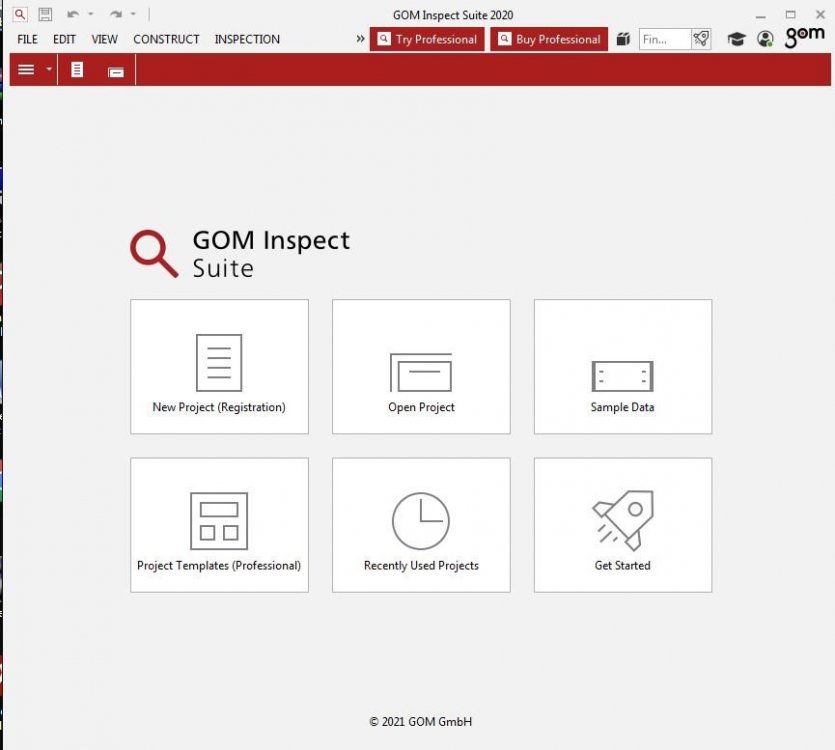

[Ph...] Posted January 11, 2022 Share Posted January 11, 2022 I have just downloaded the free Gom Inspect Suite 2020 Hotfix6(the last version I assume) then I installed the software.Everything went smoothly. Then I launched the software,I logged in(I registered before).The small circle to the right of the icon indicates the login status.It's green meaning everything is Ok but in fact I can't create new project,I can't import CAD etc..What's wrong. Look at the image file attached showing the green circle at top right and the icon :New project(Registration) asking me to be registrated Does anyone can help me?Thanks in advance. Link to comment https://qualityforum.zeiss.com/topic/637-gom-inspect-suite-2020cant-access-to-functionality-even-registered-and-logged-in/ Share on other sites More sharing options...
[Na...] Posted January 11, 2022 Share Posted January 11, 2022 Hello Philippe, please Download the GOM Software 2021 here: GOM Software 2021 Download This is the newest version. You might have to request a free licence for the 2021 to create a new project etc. Regards, Nanno Link to comment https://qualityforum.zeiss.com/topic/637-gom-inspect-suite-2020cant-access-to-functionality-even-registered-and-logged-in/#findComment-1912 Share on other sites More sharing options...

[Ph...] Posted January 25, 2022 Author Share Posted January 25, 2022 Hello Nanno, I see that I'm not alone with my problem of Free Gom Inspect Suite 2020 licence, Viktor has some concerns too. I read somewhere in Gom FAQ:''The free Basic GOM Software licenses are valid until January 1st of the second year after the initial release. After this date the GOM Software will automatically be converted to a Viewer, a new activation of this free License is no more possible." Is that true, we have no more access at Free Gom Inspect Suite 2020 licence ?? Do we have to download the Free Gom Inspect Suite 2021software now? It's a shame because I heard that with the Free Gom suite 2021 the blade functionalities are no more accessible. Thanks. Philippe. Link to comment https://qualityforum.zeiss.com/topic/637-gom-inspect-suite-2020cant-access-to-functionality-even-registered-and-logged-in/#findComment-1988 Share on other sites More sharing options...
[Na...] Posted January 26, 2022 Share Posted January 26, 2022 Hello Philippe, it is true, the free license of the 2020 is not available anymore since January 1st. You need to upgrade to the 2021. if you are missing blade functionalities you will probably find them in the free version of Blade Inspect. Regards, Nanno Link to comment https://qualityforum.zeiss.com/topic/637-gom-inspect-suite-2020cant-access-to-functionality-even-registered-and-logged-in/#findComment-2006 Share on other sites More sharing options...
