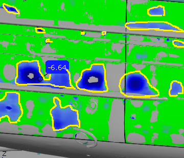

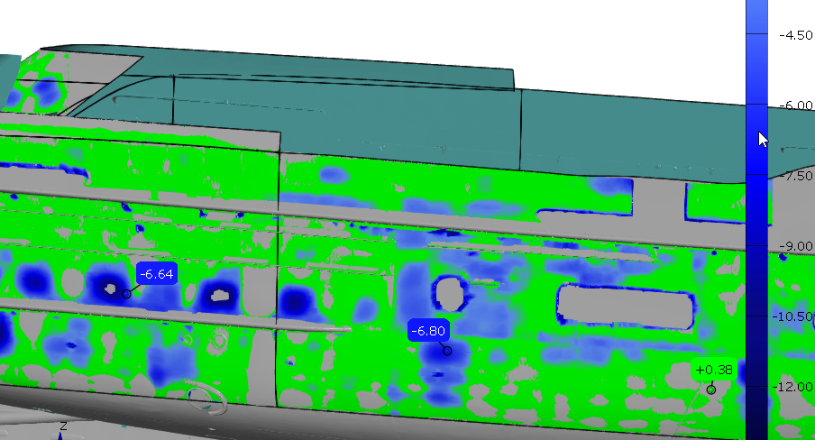

[Lu...] Posted January 20, 2022 Share Posted January 20, 2022 Hello, I was wondering if its possible with GOM Inspect (free edition), to automatically make contour curves on the edges of certain inspection values. You could compare the result like a sort of 2D DEM map, but then in 3D and directly on the inspection mesh, representing region with a certain value. See the screencap, if i want a curve representing all the blue spots, done automatically based on the inspection value, is this possible. I drew here the desired result with yellow lines (3d curves) which i want to export to a CAD software like Rhino: Any suggestions how to do this in Gom Inspect? Or is this not possible? Link to comment https://qualityforum.zeiss.com/topic/648-contour-curves-on-borders-of-inspection-results/ Share on other sites More sharing options...
[Be...] Posted January 21, 2022 Share Posted January 21, 2022 Hi, unfortunately this is not possible in the moment as far as I know. You can visualize these "curves" with a discrete legend, but in the moment we don't offer any export or creation as an element which could be exported. Regards, Bernd Link to comment https://qualityforum.zeiss.com/topic/648-contour-curves-on-borders-of-inspection-results/#findComment-1953 Share on other sites More sharing options...
[Na...] Posted January 24, 2022 Share Posted January 24, 2022 Hello, with a Pro license you could create a surface defect map and export the boundary lines of the defects with scripting. Scripting is not available in the free version though. Regards, Nanno Link to comment https://qualityforum.zeiss.com/topic/648-contour-curves-on-borders-of-inspection-results/#findComment-1980 Share on other sites More sharing options...
