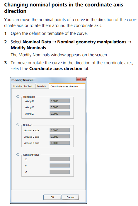

[Am...] Posted May 30, 2025 Share Posted May 30, 2025 Please sign in to view this quote. How to adjust the Z value after scanning exp:500 point Link to comment https://qualityforum.zeiss.com/topic/6594-how-to-scan-unknown-curve-using-using-2d-curve/#findComment-133003 Share on other sites More sharing options...
[Ma...] Posted June 2, 2025 Share Posted June 2, 2025 Please sign in to view this username. It depends on your curve nominals. In Calypso 2023 manual - page 1-40 there is guide for changing nominals. You can move all points in same direction ( translation ) - you can rotate all points along axis ( rotation ) or you can force to every point specific value ( constant value ) If you want to get the points straight / paralell with axis, then use constant value If you want to move curve, then use translation. Link to comment https://qualityforum.zeiss.com/topic/6594-how-to-scan-unknown-curve-using-using-2d-curve/#findComment-133037 Share on other sites More sharing options...
