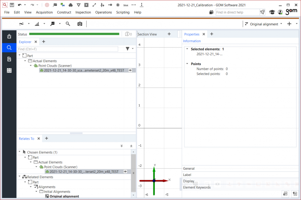

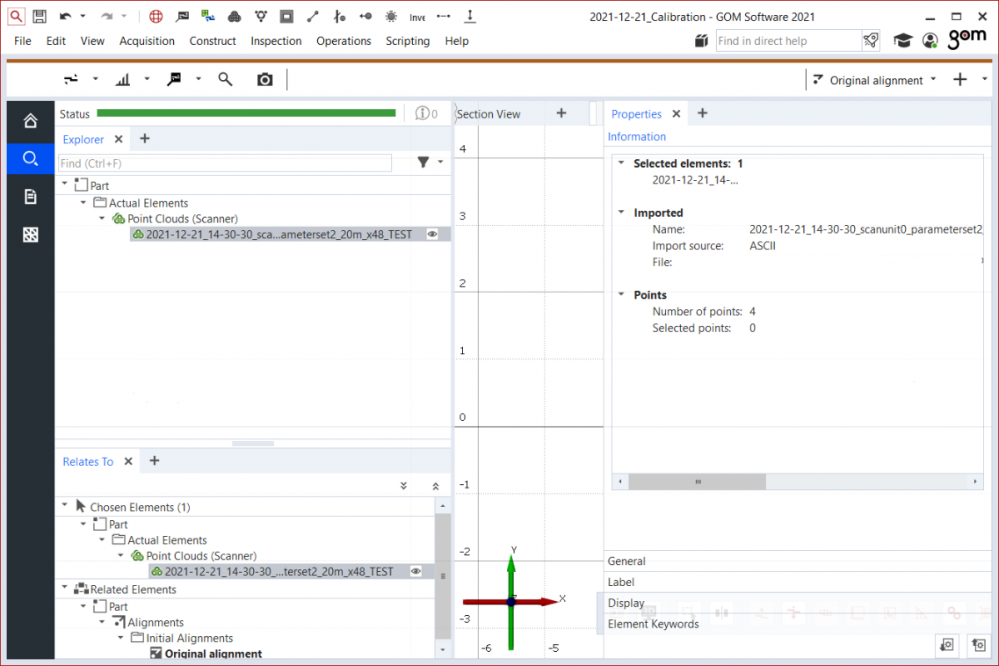

[Th...] Posted January 25, 2022 Share Posted January 25, 2022 (edited) Hi, I watched an issue with moving point clouds into a new part. Easiely to reproduce : New Project Drag an Ascii File with points into the project (target: clipboard) Save project Drag the point cloud into from clipboard a new part Name the Part "Part" Save the project After Step 3 the point cloud contains all points (after reloading the project). After Step 6 the point cloud contains "0" points (after reloading the project). Perhaps I am missing something but this looks suspicious... Best regards Thorsten 2021-12-21_14-30-30_scanunit0_parameterset2_20m_x48_TEST.asc Edited January 25, 2022 Link to comment Share on other sites More sharing options...

[Th...] Posted February 10, 2022 Author Share Posted February 10, 2022 I think I have found the cause for this bug. My project file lies in a folder containing the german character "Ü". If I remove all "special" characters from the folder path, it works as expected. I reproduced this behaviour with GOM Inspect 2019 (Free). I am working under Windows 11. Link to comment Share on other sites More sharing options...
