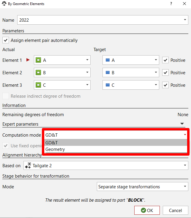

[So...] Posted January 26, 2022 Share Posted January 26, 2022 By geometric elements alignment, the difference between geometry and GD&T Link to comment https://qualityforum.zeiss.com/topic/663-by-geometric-elements-alignment-the-difference-between-geometry-and-gdt/ Share on other sites More sharing options...
[Na...] Posted January 26, 2022 Share Posted January 26, 2022 Hello, if you click the "?" on the top right there is a description in the direct help (expand "Menu Elements"). With GD&T the alignment is calculated like a datum system. Regards, Nanno Link to comment https://qualityforum.zeiss.com/topic/663-by-geometric-elements-alignment-the-difference-between-geometry-and-gdt/#findComment-2004 Share on other sites More sharing options...
[ca...] Posted January 17, 2023 Share Posted January 17, 2023 Hello Nanno, I also have a similar question about that. When we select geometry as mode, even if we do not have perfect datum reference features (three perpendicular plane), it tilts the system and create a perfect datum system. However, lets say we have some reference features which have certain degree in between them, and we need to use these reference features as datums. In that case, then i guess alignment by coordinate system function would be much more healthier to create a datum system, does it make sense? Thanks, Canset Link to comment https://qualityforum.zeiss.com/topic/663-by-geometric-elements-alignment-the-difference-between-geometry-and-gdt/#findComment-6534 Share on other sites More sharing options...
[Be...] Posted January 17, 2023 Share Posted January 17, 2023 Hi, if you need the (more complex) functionality of the 'Datum system' to define your actual and nominal coordinate system then you have to use the 'Alignment by coordinate system' functionality to ensure an alignment which is based on these datum system definitions. Regards, Bernd Link to comment https://qualityforum.zeiss.com/topic/663-by-geometric-elements-alignment-the-difference-between-geometry-and-gdt/#findComment-6536 Share on other sites More sharing options...
