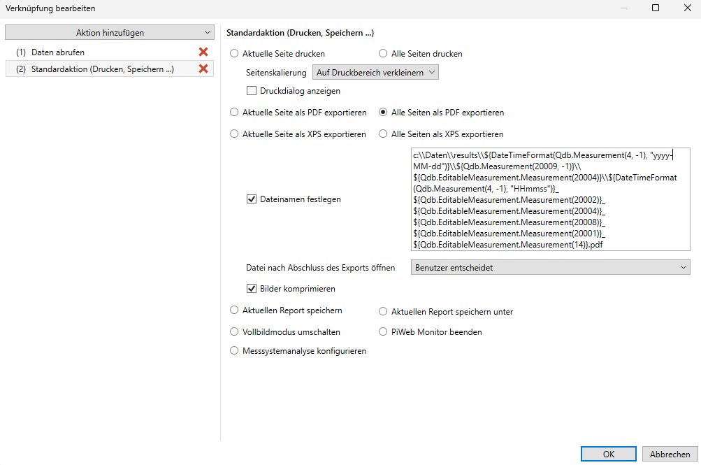

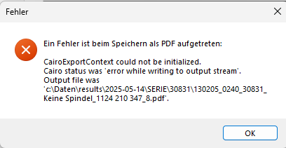

[Th...] Posted May 14, 2025 Share Posted May 14, 2025 Hello. I have a similar problem, so I'll add to this post. I want to use the PDF export button on the report to create a PDF in the same folder in which the automatically created report is already saved. For example, because plots are still being added. I have now made several attempts, but I can't get it to work. As long as I use a variable to determine the file name, it works. eg. c:\\daten\\results\\${DateTimeFormat(Qdb.Measurement(4, -1), "yyyy-MM-dd")}test.pdf But if I want to use several variables in the path to determine the path, I always get the error as shown in the screenshot. The following would be my attempt where the error always occurs. c:\\Daten\\results\\${DateTimeFormat(Qdb.Measurement(4, -1), "yyyy-MM-dd")}\\${Qdb.Measurement(20009, -1)}\\${Qdb.EditableMeasurement.Measurement(20004)}\\${DateTimeFormat(Qdb.Measurement(4, -1), "HHmmss")}_${Qdb.EditableMeasurement.Measurement(20002)}_${Qdb.EditableMeasurement.Measurement(20004)}_${Qdb.EditableMeasurement.Measurement(20008)}_${Qdb.EditableMeasurement.Measurement(20001)}_${Qdb.EditableMeasurement.Measurement(14)}.pdf A screenshot of the non-functioning entry in PiWeb Would be great if someone could help me. Link to comment https://qualityforum.zeiss.com/topic/6678-how-can-i-use-variables-to-name-filespaths-on-piweb-exports/#findComment-132111 Share on other sites More sharing options...
