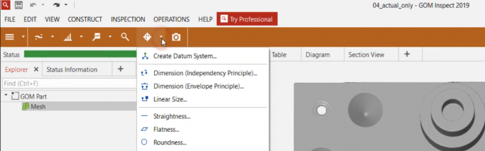

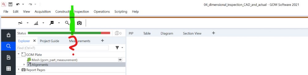

[Gi...] Posted February 8, 2022 Share Posted February 8, 2022 I just visited one of those tutorials (https://training.gom.com/course/71083/module/95860?LPId=0) and in the latest version of GOM Inspect (2021 hotfix 3), this button (GD&T) is missing. Can the toolbar be customized? Thanks! This is GOM 2019: This is 2021: Link to comment https://qualityforum.zeiss.com/topic/685-2021-hotfix-3-missing-gdt-in-main-toolbar/ Share on other sites More sharing options...

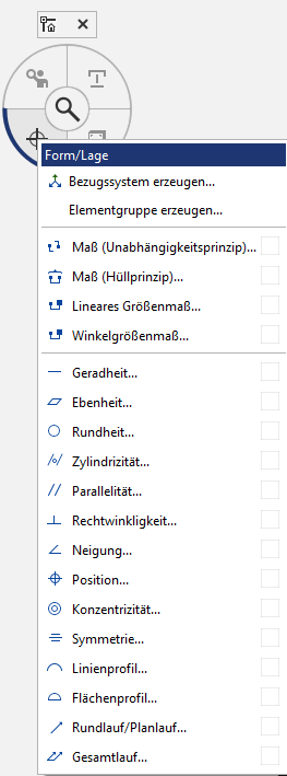

[Na...] Posted February 8, 2022 Share Posted February 8, 2022 Hello Gilbert, this function is now included in I-Inspect. If you click on the GD&T symbol (while nothing is selected) the GD&T quick creation will appear. The toolbar cannot be customized, but you can drag and drop any function from the menu to the top of the software or into the tool bar on the bottom of the 3D view. Regards, Nanno Link to comment https://qualityforum.zeiss.com/topic/685-2021-hotfix-3-missing-gdt-in-main-toolbar/#findComment-2078 Share on other sites More sharing options...
[Gi...] Posted February 8, 2022 Author Share Posted February 8, 2022 Thank you, Nanno. That's what I was missing! Link to comment https://qualityforum.zeiss.com/topic/685-2021-hotfix-3-missing-gdt-in-main-toolbar/#findComment-2082 Share on other sites More sharing options...
