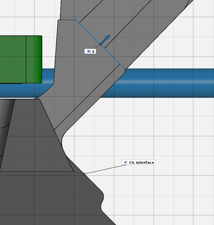

[Jo...] Posted February 15, 2022 Share Posted February 15, 2022 Hello, How can you measure parallel plane/surfaces pointing in the same direction? In the screenshot plane X and surface CG interface. Should I use the caliper, or is there another measurement feature to construct? Thanks in advance. Johnny Link to comment https://qualityforum.zeiss.com/topic/697-measure-parallel-planes/ Share on other sites More sharing options...
[84...] Posted February 15, 2022 Share Posted February 15, 2022 Hi Johnny, I want to show you in this post the option to project one surface on the other plane with the function "deviation to geometry". Maybe this helps in your case. For the workflow see the video attached. Best regards, Matthias 1703219991_DeviationtoGeometry.mp4 Link to comment https://qualityforum.zeiss.com/topic/697-measure-parallel-planes/#findComment-2122 Share on other sites More sharing options...

[Lu...] Posted February 19, 2022 Share Posted February 19, 2022 Hi. i put Surface Points on one of the surfaces then create distances with "Projected point distance" command using the plane on the other surface. But if you need min and max "deviation to geometry" is the way to go. Link to comment https://qualityforum.zeiss.com/topic/697-measure-parallel-planes/#findComment-2149 Share on other sites More sharing options...
