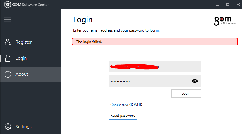

[83...] Posted January 29, 2021 Share Posted January 29, 2021 ++Repost GUILIE++ Hello, I have just installed The free Gom Inspect Suite2020 but I can't access to functionalities like new project, import data etc.. I thought it would be possible to get the full functionality I am used to have with the free GOM Inspect 2019 but not. The software asked me to register a GOM ID in order to get a free licence but I have got it yet since April 2020. Then I tried to follow the Gom Help as described below: "To register, click the user icon at the top right of the software. The small circle to the right of the icon indicates the login status. If the circle is displayed in gray, you are not logged in. If you are logged in, the circle is green." I succeed to login but the circle stayed gray and I haven't got more functionalities. Can you advise,please? Thanks Link to comment https://qualityforum.zeiss.com/topic/70-free-gom-inspect-suite-2020-cant-access-to-functionalities/ Share on other sites More sharing options...

[Ph...] Posted January 29, 2021 Share Posted January 29, 2021 Hello. Since end of november I can't access to Gom Inspect Suite 2020 Hotfix2.Everything worked before but now it's impossible to login.The login failed. The dot at the top right stay grey not green.Could you help? Best regards. Link to comment https://qualityforum.zeiss.com/topic/70-free-gom-inspect-suite-2020-cant-access-to-functionalities/#findComment-193 Share on other sites More sharing options...

[Ti...] Posted February 2, 2021 Share Posted February 2, 2021 I'm having the same issue when trying to use GOM Inspect 2020, and I think it's a connection error somehow as if I choose the "register" tab it says "Cannot load the registration form". Login just says "Login failed". I've tried all three proxy options, and while it works a bit longer with manual proxy set it leads to the same results. I was a bit in contact with support about it and the advice I got was to uninstall and then reinstall my CodeMeter drivers, though I haven't dared to do so since both my scanning system (a Zeiss T-Scan) and PolyWorks use codemeter licenses. Link to comment https://qualityforum.zeiss.com/topic/70-free-gom-inspect-suite-2020-cant-access-to-functionalities/#findComment-208 Share on other sites More sharing options...

[Jo...] Posted March 16, 2021 Share Posted March 16, 2021 New user with the same problems but Capture 3D help solve the issue. From the START menu find GOM Software Center and right click Run as Administrator. This brought up the login screen and allowed me login. Maybe running GOM Inspect Suite as administrator will work in bring up the login screen. Link to comment https://qualityforum.zeiss.com/topic/70-free-gom-inspect-suite-2020-cant-access-to-functionalities/#findComment-370 Share on other sites More sharing options...
[Me...] Posted April 9, 2021 Share Posted April 9, 2021 From the START menu find GOM Software Center and right click Run as Administrator. This brought up the login screen and allowed me login. Maybe running GOM Inspect Suite as administrator will work in bring up the login screen. I do this and the problem is fixed. Link to comment https://qualityforum.zeiss.com/topic/70-free-gom-inspect-suite-2020-cant-access-to-functionalities/#findComment-452 Share on other sites More sharing options...
